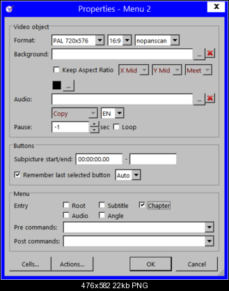

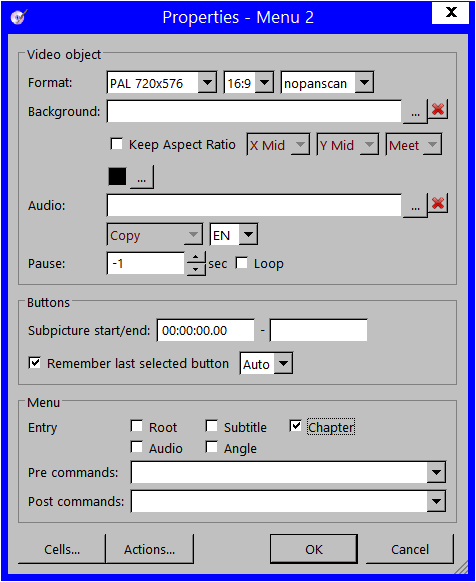

  2. Maybe I don't understand your problem but when I need a "chapter menu" (I'm a bit ambiguous about the term because I learned it means different things to different people)I add a menu and select it's entry to Chapter.

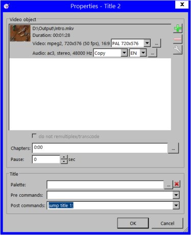

  3. Rereading the post:
    Let the trailer be title 2. As action for the button you want to play the movie let it jump to title 2. As post command for title 2 have it jump to title 1 and as it's post command call what you consider main menu.
    As for your chapter menu (and sub menues) perhaps watch this
    https://www.youtube.com/watch?v=w0jIx0dukXU
  4. What would be the post command?

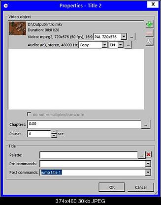

  5. If you double click a title you'll get it's Property Sheet and find the post command here:
