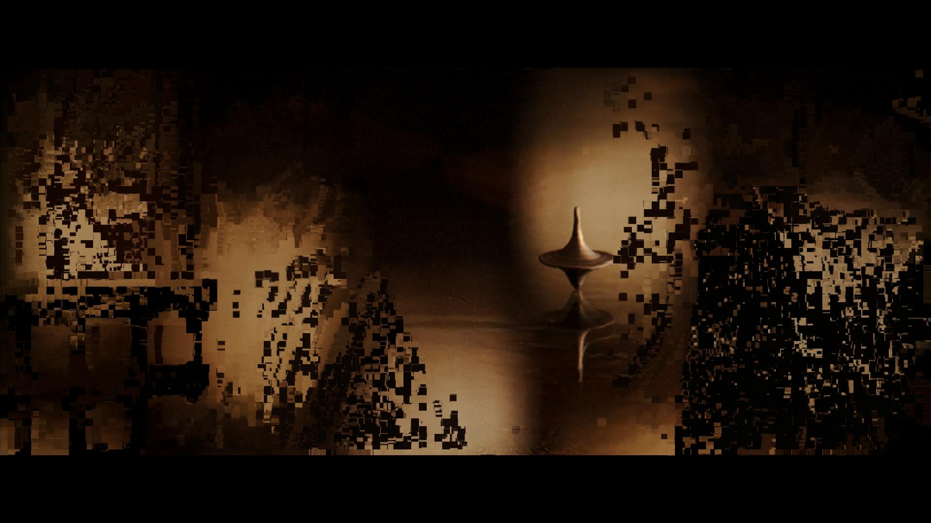

    I am attempting to rip the main title on my copy of the Inception blu-ray to an MKV container using MKVToolnix.
    I use BDinfo to identify the proper playlist, and simply drag and drop the playlist file in the MKVToolnix GUI. I select the tracks I want and start muxing. I've done this for hundreds of blu-ray playlist files, but with this one there seems to be an issue in the muxing process (even though I get no errors or warnings).
    At certain points in the final muxed MKV, I get visual corruption in the image:
    It turns out these correspond to the points at which the various M2TS files specified in the playlist are joined. Whenever there is a join, the same kind of corruption occurs. This is first time this has happened, any ideas what could be causing it?
    I've added no intermediate steps to modify the files from the blu-ray disc, just adding the playlist straight to mkvtoolnix. Furthermore, the issue occurs whether I play the MKV file in Media Player Classic HC or in Windows 10 Windows Media Player. However, the issue does not occur if I just load the playlist directly in MPC:HC.
