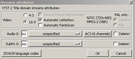

    Like you, Skiller, I immediately thought of PGCEdit. At least that way, after the person gets a widescreen television he'll be able to play it in the intended aspect ratio. Maybe some authoring programs can do it during authoring time, but PGCEdit can easily do it after authoring so that it plays as cropped 1.33:1 on old 'square' televisions.
    Open the DVD and highlight and right-click on the movie. In the choices that open up hit 'Domain Stream Attributes'. The common way widescreen films are set up is for 'Automatic Letterbox'. Just check 'Automatic Pan&Scan' instead'. 'OK' back to the main screen and File->Save DVD. No reencoding, no ruining for all time the aspect ratio.
Name:	Streams Attributes.jpg
