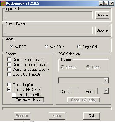

Did you try to process a VOB file just as it was authored on DVD (ripped in "File" or "ISO" mode)? Then there is no surprise. DGIndex doesn't analyze IFO files, therefore doesn't care about the logical structure of VOB files, and authoring additions may cause shifts between video and audio. You must extract the main movie PGC to be processed with DGIndex (either rip only the main movie in "IFO"/"Movie" mode, or extract the desired Program Chain from an already completely ripped DVD to a PGCVOB with PGCDemux).

You probably decrypted it incorrectly and it still has unreferenced cell(s). You can confirm (or disprove) by checking the cells using PGCDemux. In any event, as long as it's out of synch by a constant amount, discover exactly what it is and remux it, taking the delay into account. Or, when creating the D2V to begin with, cut off the black frames before the actual video.

Maybe you should have. Not because it was decrypted, because apparently it wasn't. But because a good decrypter would have removed any unreferenced cells.I did not decrypt the DVD at all....
An unreferenced cell consists of some frames of black (10 or so if you have a 400ms delay) without audio usually found at the beginning of the video, but sometimes elsewhere in the video. It wouldn't show any delay because there isn't any for that cell (partly because there's no audio at all). The DVD knows how to handle it but when you reencode it without having first removed any unreferenced cells, the audio 'slides' forward to the beginning because there's no silent audio there to keep that from happening.

Bingo. Cells 1 and 2 are unreferenced. You can also save a PGC VOB from PGCDemux for use directly in whatever you're using to reencode. Or make the D2V file with DGIndex from either the M2V or the PGC VOB. Or you can just deal with the out of synch audio by remuxing with the delay taken into account. You're making a mountain out of a molehill.

Yes, a PGC VOB. A VOB file of just the episode, audio and video. You could also check the VOB IDs and might find a little one before the episode you're trying to get. That is, the unreferenced cell might not be 1 or 2, but somewhere else. You might also find a clue by checking all the PGCs for short cells. Again, though, this isn't such a big problem that it can be easily dealt with.
