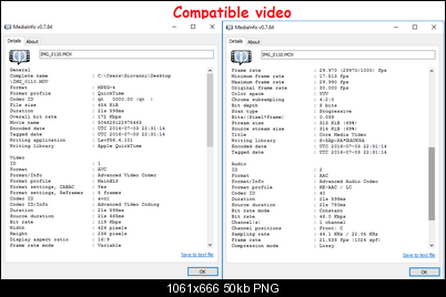

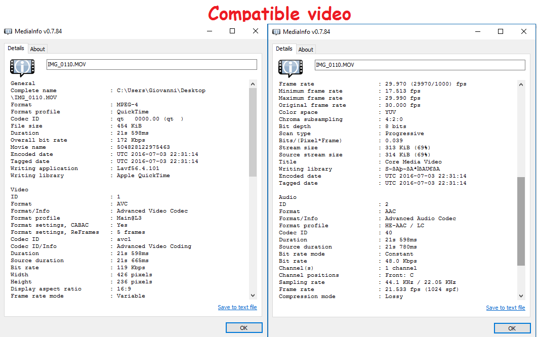

    In my iPhone I installed an application that can detect a single type of video that is, the type of video MOV.
    But the same type of video .MOV recorded by mobile phone is not compatible with this application and I would like to know how to make it compatible.
    These are the characteristics of compatible video captured by Media Info:

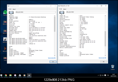

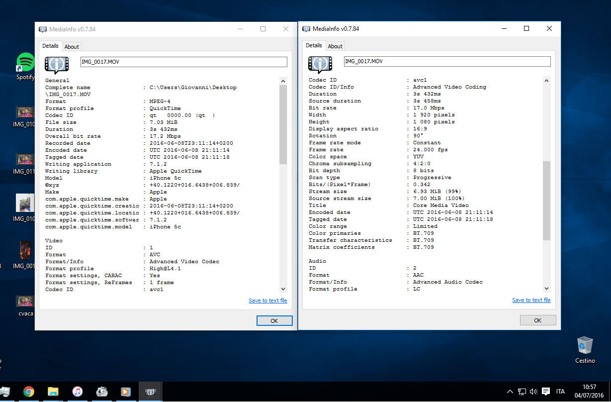

    and instead of this other are the characteristics of the video incompatible:

  2. Both videos are crap... main difference seem to be profile (Main vs Base), side to this there are differences in container (quicktime vs ISO mp4 - not sure if this is important) and seem different aspect ratio (1:1 vs 16:9).

    How can I convert a Base Profile in a Main profile ??
  5. I'm a MEGA Super Moderator Baldrick's Avatar
    You could try reconvert the video with Handbrake. Use the Normal Profile to get the Main profile(you can also adjust it under the video tab and h264 profile) .
    The incompatible video has the high profile.
    Jul 2016
    italy
    THANKS MAN ITS WORK FINE!!! THANKS A LOT!!
