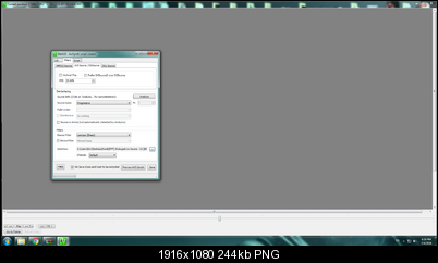

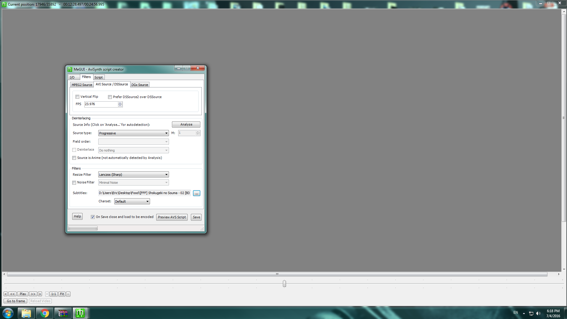

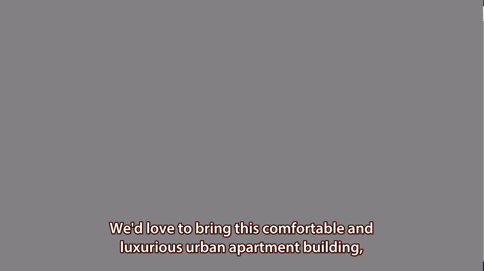

    Using MeGUI, I'm trying to hardsub subtitles into videos for better playback. However, I had a problem with AVS Script Creator because when I tried to add a video input it'd say that the correct filters weren't installed. So I proceeded to install Haali Media Splitter and it worked. But, when I encoded everything and looked back at the video, the entire video was completely grey and the subtitles and audio were completely fine.

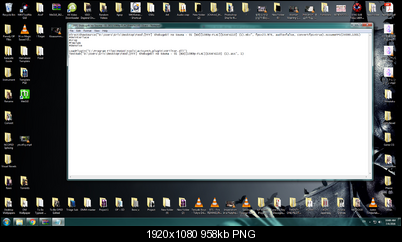

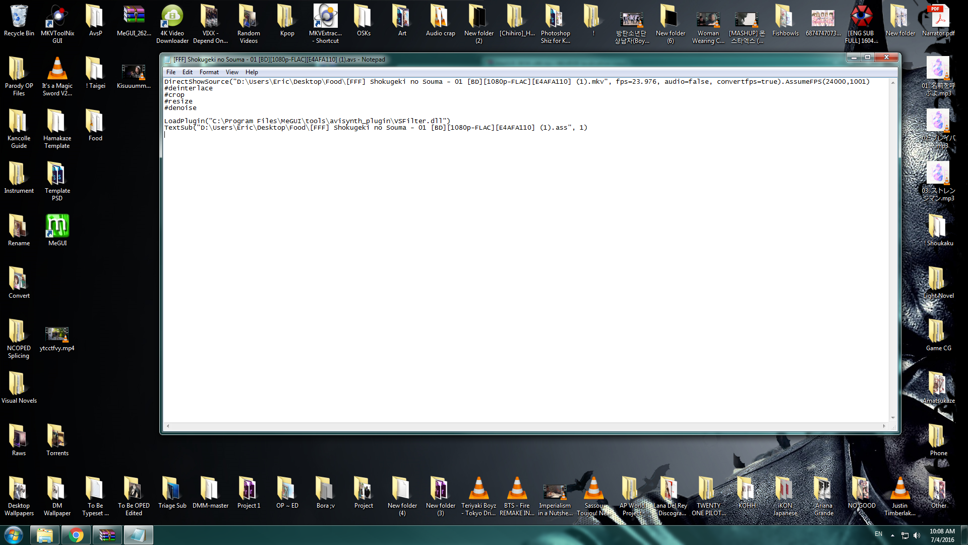

  3. Click image for larger version
    I believe that's the avs script made from the avs script creator

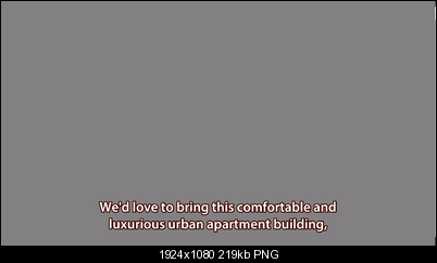

    Can you play the video with with windows media player?
  5. Click image for larger version
    Another picture for reference because i thought the problem was in the video i was using... but its not

    Left is the original and right is after MeGUI (the grey video)
