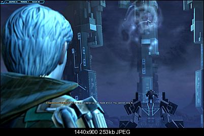

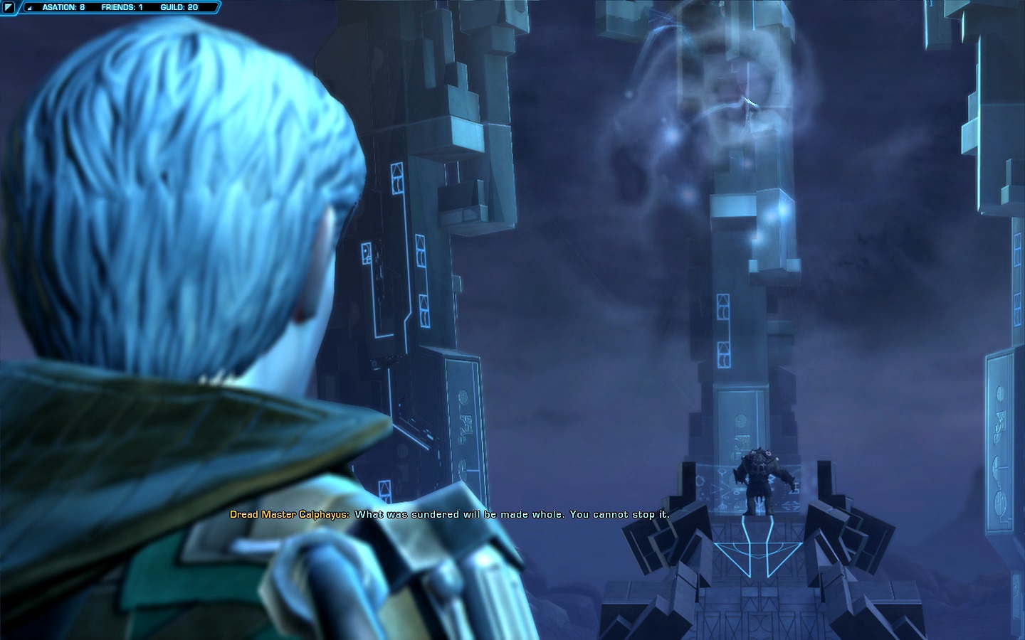

    x264 program --preset placebo --tune film --crf 16 --output "output" "input" on 1.15GB video file (FRAPS recorder) and got 36.9 MB video file as output, but i got two problem. First video becoming less smooth and quality really drop. I don't need that much deacrese in file size, so can someone advice what settings i should use or what converter?
    P.S. Sorry i wasn't able to find spoiler tag
    Original
Name:	swtor 2013-01-03 19-40-06-54.avi_20160704_012454.051.jpg
    Output
Name:	swtor 2013-01-03 19-40-06-54.mp4_20160704_012435.940.jpg

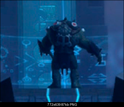

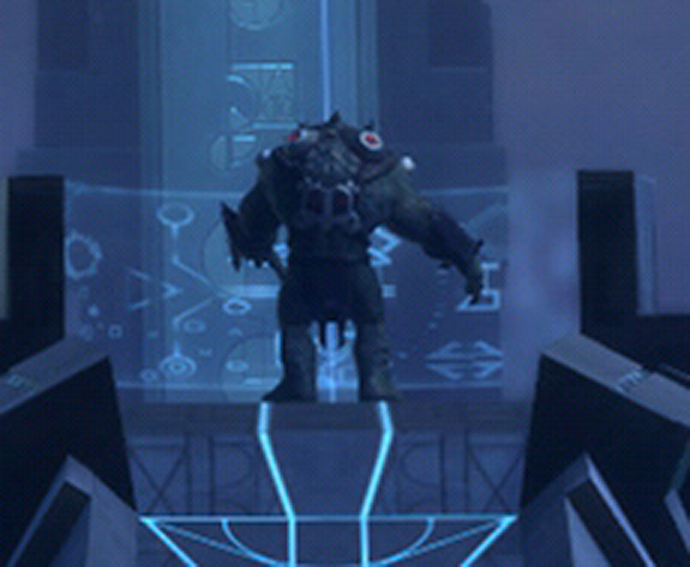

    Original
Name:	2016-07-04 01_39_17-Без имени-4 @ 459% (С&.png

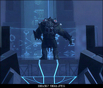

    Output
Name:	2016-07-04 01_38_50-Без имени-3 @ 459% (С&.png

    Use a lower CRF. A CRF of 0 is lossless but I would not recommend as the file will probably be bigger than your source. Maybe try CRF 10-14.
  3. You're always going to get DCT ringing artifacts like that with DCT based codecs. You might get a little less at a lower CRF. At CRF=0 (if your encoder allows it) you will get lossless encoding but you'll also get very little compression and few devices outside a computer will play it.
  4. Originally Posted by jagabo View Post

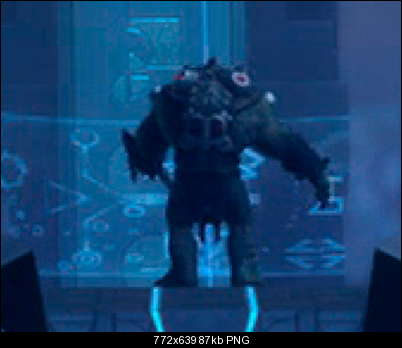

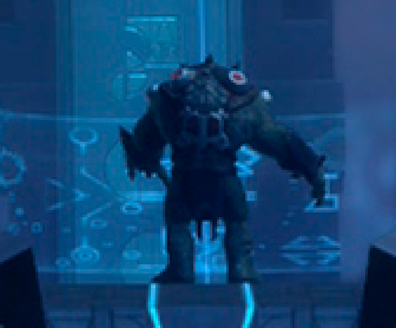

    Thanks for answer that helped with quality problem (Not ideal, but for detect quality drop you actually need to look in frame)

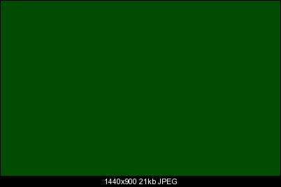

    but now i got green screen as the last frame in video, this is normal for video converted with this settings?
Name:	swtor 2013-01-03 19-40-06-54.mp4_20160704_122236.363.jpg

  5. Regarding the changes in the image: it looks like you're using a debanding filter that's dithering. That's the cause of the change in the "out" image.
    You shouldn't be getting a green frame at the end of the video. How are you viewing it and exporting the screen shot? The problem is probably there, not the video itself.
    Another thing you can do to improve quality is disable b-frames, --bframes=0.

  24. Originally Posted by poisondeathray View Post
    And the video you uploaded wasn't fraps, it was decompressed by vdub to uncompressed 8bit RGB
    You should have used video=>direct stream copy in vdub. You probably had it on video=>full processing mode
    So maybe you aren't recording fraps RGB mode
    Ok...This is strange. Because i realy used Direct Stream Copy in video in VDUB... Anyway my bad. I don't know why, but VDUB changed file. There right copy
    https://yadi.sk/i/Hs4qEtUYszZnL
    And this is output
    https://yadi.sk/i/UmWQA5rnszaBT
  25. well look at the 12 fps framerate, so you've decimated the frames 210 (with duplicates) vs. 84 (also with duplicates and drops)
    The levels are also messed up, and you used 10bit encoding , not sure if that was intentional
  26. Originally Posted by poisondeathray View Post
    I guess more accidentally then intentional... And yeah... 12 fps is strange...that also explains why in other video everything is normal...yeah i'm stupid enough to not check framerate ..thanks...but i got one more question...how i can fix it?
  27. Just erase the tdecimate line you had earlier, that will fix it . I have no idea why megui would have added it for one video
    Did you notice the contrast was different? For example,some of shadow detail is crushed. The levels (if you want it to look the same as the original), should use "TV" levels.
    If you use LWLibavVideoSource(), it will decode fraps as full range YUV. So you need to add something to bring the levels back to normal range y=16 to 235
    You could use smoothlevels, for example. It's preferred to plain levels or coloryuv because it dithers (less banding)
    So it would look something like this
    SmoothLevels(preset="PC2TV")
    But beware some versions of LSmash have problems with fraps, it might decode out of order. Same with some versions of FFMS2. They are still preferred to AVISource for the non RGB version of fraps if your goal was YV12 4:2:0 "normal" video encoding. There will be less quality loss then decoding RGB and going back to YV12
  28. Originally Posted by poisondeathray View Post
    I don't have "tdecimate" in script file, this line was in wrong avi file that VDUB created because of strange settings.
    For someone who never used that kind of settings, i need to input this lines in created script files, right?
    Basically script will look like this, right?
    global MeGUI_darx = 8
    global MeGUI_dary = 5
    LoadPlugin("C:\MeGUI_2624_x86\tools\lsmash\LSMASHS ource.dll")
    LWLibavVideoSource("FILE_PATH")
    #Not enough useful sections for source detection. Doing no processing
    #crop
    #resize
    #denoise
  29. take out the global lines. You can erase them or add a "#" in front
    #global MeGUI_darx = 8
    #global MeGUI_dary = 5
    Smoothlevels is 3rd party plugin, it might have to be loaded separately if you don't already have it in your plugins folder it's smoothadjust.dll
    The "FILE_PATH" is the actual path and name of the video
    e.g it might look like this
    LWLibavVideoSource("L:\SWTOR Old\55y5cgtf.3oy\swtor 2012-12-25 20-46-52-81.avi")
  30. Originally Posted by poisondeathray View Post
    Ok...
    Now script file looks like this
    LoadPlugin("C:\MeGUI_2624_x86\tools\avisynth_plugi n\SmoothAdjust.dll")
    LWLibavVideoSource("C:\Users\Admin\Desktop\swtor 2012-12-25 20-46-52-81 7 sec.avi")
    SmoothLevels(preset="pc2tv")
    #deinterlace
    #crop
    #resize
    #denoise
    And i got this
    https://yadi.sk/i/sN8mNqd5szisE
    I'm totally lost...
