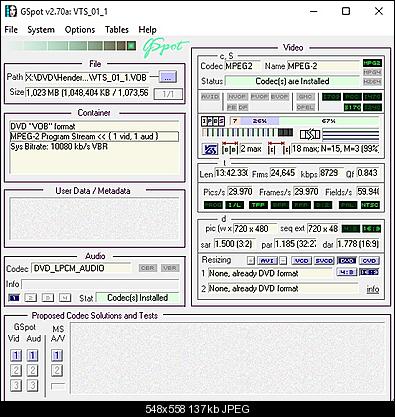

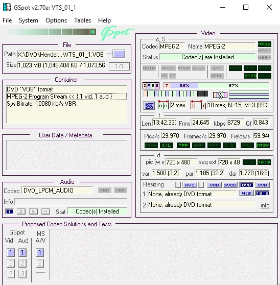

Here's the G-SPot screen of one of the VOBs:

I would try demux the dvd with pgcdemux and then try play the m2v videostream with vlc and see how it plays.
Then maybe try fix/repair/remux m2v video stream with something like videoredo (using stream quickfix), TS-Doctor, etc.
Last add the m2v and audio files in dvd-lab pro.
If everything fails just try reconvert the mpg.
