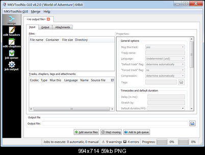

  3. Demuxing a video stream gives you an elementary stream, exactly what a demuxer is supposed to to. You shouldn't change the extension, because the files aren't MKV files. If you want the stream in an MKV file use mkvtoolnixgui, deselect all the tracks you don't want, then mux.

    It is a demuxer, not a muxer. Use mkvtoolnix-gui to mux.

  6. Thank you soooo much. That worked. I was under the impression that a GUI for MKVToolNix was not included in the download, since I had to download a demuxer for the tool. Thanks for lending a hand. In the meantime I was able to complete my project, using AVIdemux.
