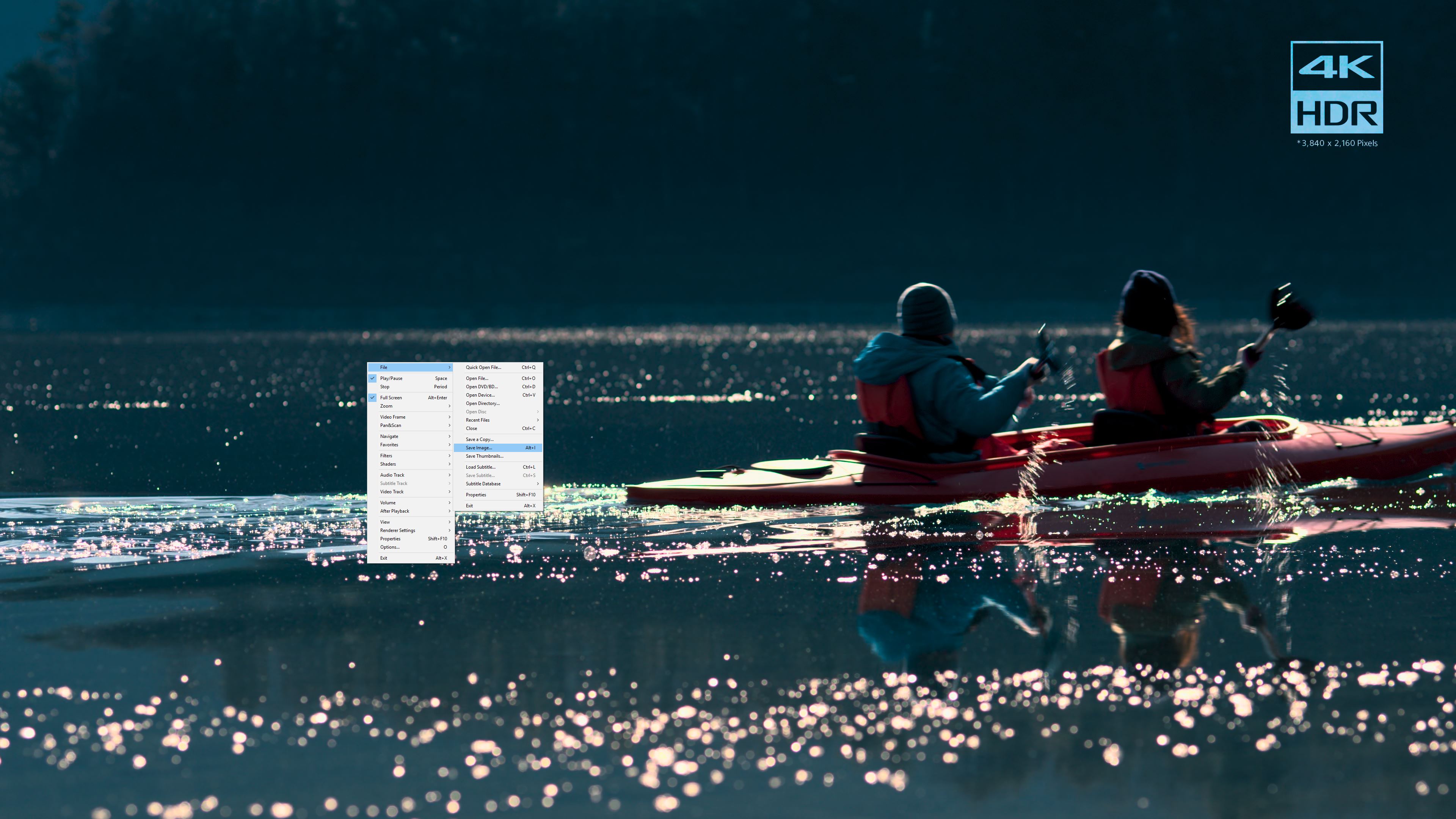

    very easy:
    mpc-hc / right click / file / save image .... choose png for lossless picture or jpg for compressed picture
