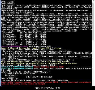

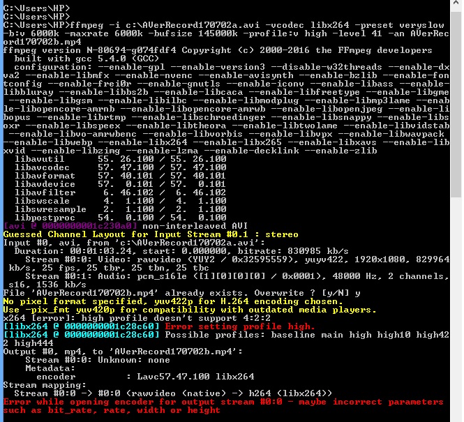

    i'm using zeranoe FFmpeg Build Version: 2a8dadb (2016-07-01)
    my script : ffmpeg -i c:\AVerRecord170702a.avi -vcodec libx264 -preset veryslow -b:v 6000k -maxrate 6000k -bufsize 145000k -profile:v high -level 4.1 -an AVerRecord170702b.mp4
    i'm getting this below error when i try to convert avi to mp4
    where am i going wrong? please help.
  2. Your source is 4:2:2.
    High Profile doesn't support 4:2:2 encoding, only the "regular" 4:2:0 subsampling
    If you want to encode 4:2:2 , use high422 (ie. "-profile:v high422")
    Or convert it to 4:2:0 (e.g. -pix_fmt yuv420p) , but if you have interlaced material it needs to use interlace scaling, and you should be using interlaced encoding

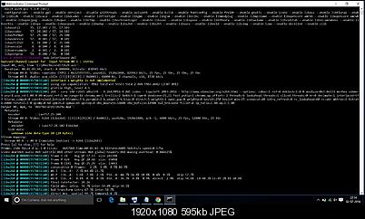

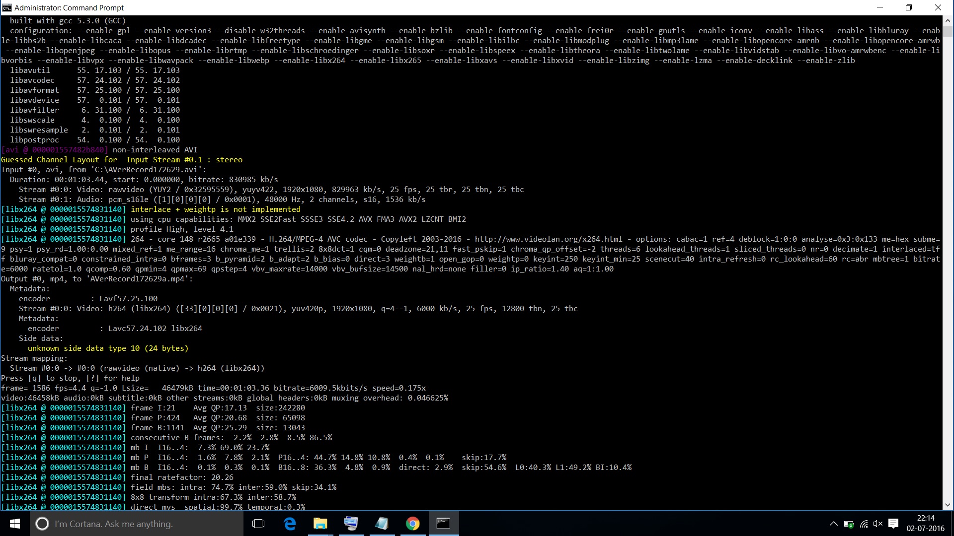

    i used this script:
    ffmpeg -i C:\AVerRecord172629.avi -pix_fmt yuv420p -bf 3 -c:v libx264 -preset veryslow -b:v 6000k -maxrate 14000k -bufsize 14500k -profile:v high -level 4.1 -flags +ildct+ilme -x264opts tff=1 -qmin 4 -subq 9 -me_method hex -an AVerRecord172629a.mp4
    i'm having dropping of frames
  7. Originally Posted by yukukuhi View Post
    Clarify what you mean by this ?
    It doesn't report any dropped frames and the time is basically the same. 1:03.44 vs. 01:03.36. The difference is probably the timebase calculation
    You also need to use interlaced scaling because the U,V planes are resized wihen you go from 4:2:2 to 4:2:0 and are keeping interlace. Otherwise you'll get chroma "ghosting"
    -vf scale=w=-1:h=-1:interl=1
