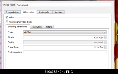

    First: I encoded them in the .avi export format in gopro studio (which didn't work), then in .mp4 and tried to use VLC media player to convert them to an .avi with MPEG-1 video, 30fps, and what I assume to be a decent bitrate (as this is the only options that I have actually had success loading the file into the software)Click image for larger version
ID:	37556. It actually loads a non-pixelated video, but not nearly the size or resolution I was hoping for.

    MPEG-1 video does not belong into an AVI container, but in an MPEG ProgramStream.
    I don't read any limitations regarding codecs in the documentation PDF. So I believe it will possibly support uncompressed UYVY / YUY2 or slightly compressed MJPEG, and maybe all VfW codecs which are installed in your Windows system (so if you want to work with GoPro AVIs, you will have to install the GoPro codec).

    That Lolitrak software was designed for Windows2000/XP and probably only support <4GB files using VfW codecs, which severely limits you when dealing with (usually HD+) GoPro clips (because either you will be using older lossy codecs - read: worse quality - to keep the filesize down, or you will be using lossless codecs to keep the quality up and pushing the limits of filesize).
    GoPro natively records as AVC-encoded video encapsulated in an MP4 container. This is NOT a good codec to work with while in an AVI container, so it makes sense to NOT AVI unless re-encoding to nearl-lossless (like Cineform), lossless (like Lagarith, HuffYUV, MagicYUV, UTvideo, etc) or uncompressed (H*U*G*E!). IIRC, GoPro studio doesn't give you all these options, just pass-through and Cineform.
    I would suggest that unless you need to use GoPro Studio's features, you convert elsewhere to a VfW-compatible lossless format (in AVI container), using something like ffmpeg.
    Make sure you've already installed the codec and that it is VfW-compatible, and then make sure your storage drives are using NTFS filesystem so that when the smaller AVC-in-MP4 GoPro files get converted, they don't have an additional filesize ceiling imposed by the filesystem.
    ...Better yet, update your Lolitrack software.
