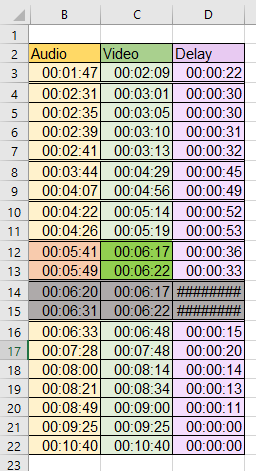

Hi, I'm more or less a complete newbie when it comes to video editing. But I do have Avidemux installed and have used it to shift audio on videos that were out of sync. Lately I've been trying to get a particular video to sync, but it just won't work.
It's a mostly silent video so I've tried using several different reference points in time but whenever it seems I've gotten one of the points synced I find that all the others are still out of place, so I'm starting to wonder if shifting the audio is enough or whether it was somehow collapsed/expanded or some other weird effect like that.

I forgot to mention that I actually have two files: one is an MP4 which is the full length of the video 11m38s and has the audio sync problems. The other is a 35s Webm with apparently no syncing problems (but it might just be because it's so short). The whole thing is just one shot, it doesn't seem to be edited in any way.
Thanks for your replies! I'll mark down as many reference points as I can to try and figure out what the problem is. -
Okay, so I've watched the whole thing while writing down all the reference points I could and discovered that the delay increases during the first half and decreases during the second half. I'm having a hard time plotting these values in a chart so I can't tell if it's a linear increase or not. But I also noticed that in the second half of the video there's some kind of skipping, as you can tell the video seems to move more quickly for a split second.
Can you guys tell which of the cases alfresco presented we're seeing here? It's obviously not the first. Any suggestions are welcome, thanks!
