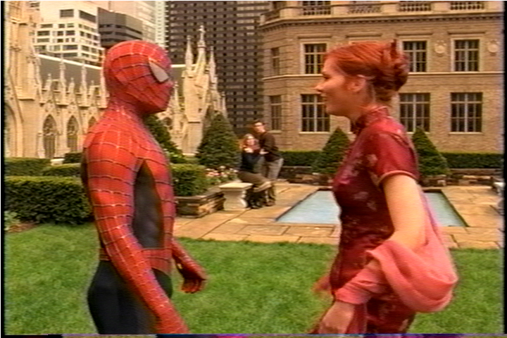

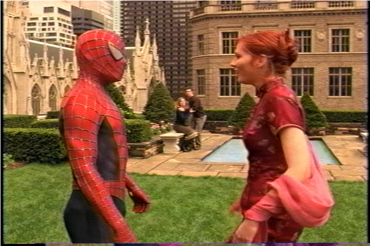

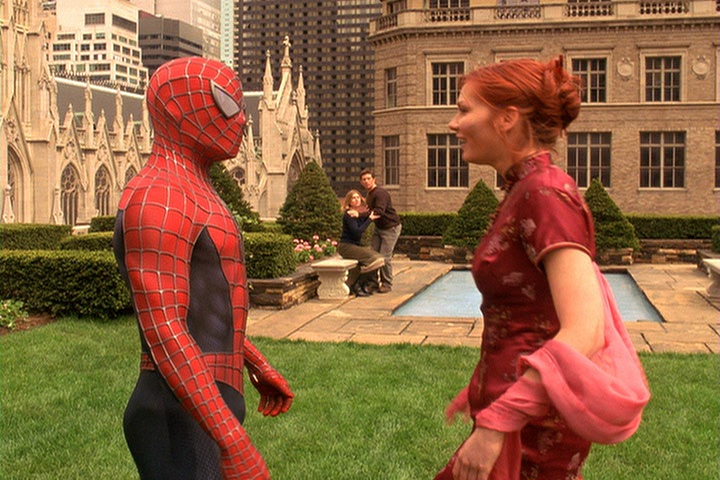

    #1 is DVD, #2 is my attempt in Avisynth, #3 is automagical tool: Color Correct v1.4 by "DrDre" on the Original Trilogy forum. (I haven't checked for new updates in the past 6 months.) [EDIT: #4 is ColourLike.]

    Red certainly looks closer in the DrDre result than my attempt, but the grass and shrubs have become the same color.
    Any suggestions for improvement?

    I have recordings of TV shows with shots that were excised from the DVD release. The surrounding scenes exist in both to compare and match.
    The Spider-Man clip is something else, but the idea is the same: the DVD has the correct colors and the VHS capture does not. I want to change the VHS to look as much like the DVD as possible.

    Thanks for the suggestion and script. I've added the result to the first post. To me, at least, the DrDre version looks closer.
