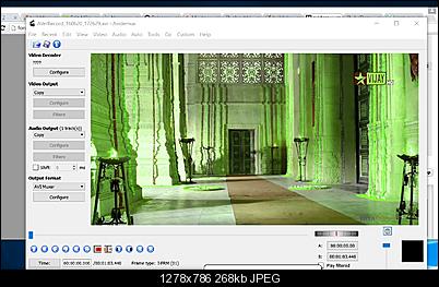

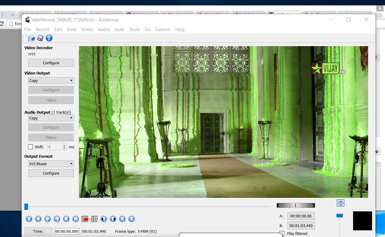

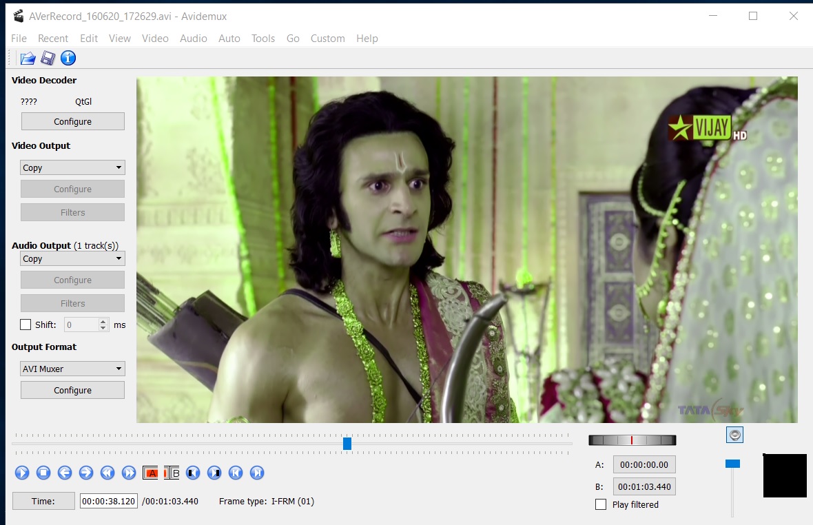

    May 2016
    India
    here it is
    it is greenish

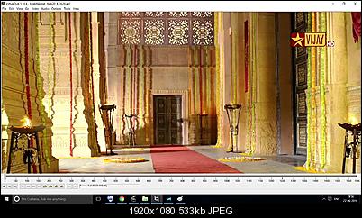

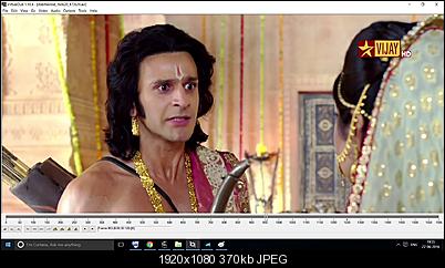

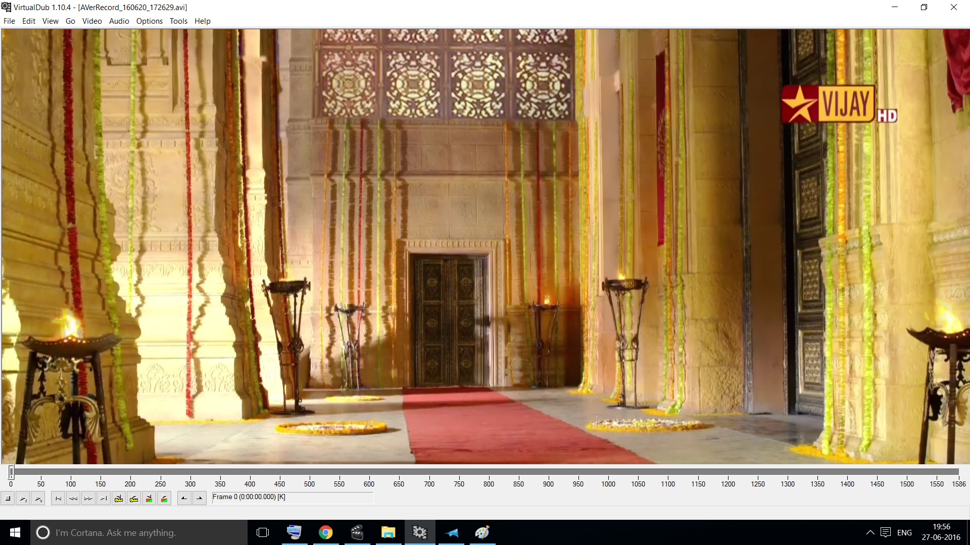

    May 2016
    India

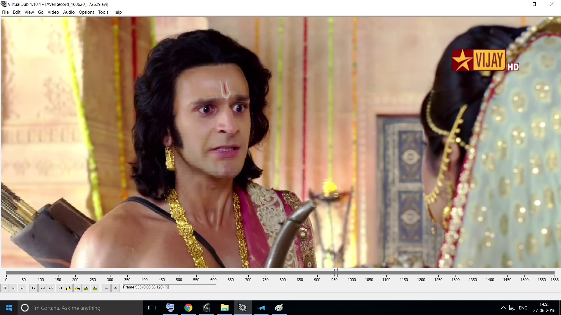

    here is some screenshot from virtual dub
ID:	37543Click image for larger version

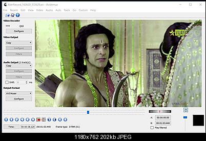

    here is some screenshot from avidemux
ID:	37545Click image for larger version
  14. Dinosaur Supervisor KarMa's Avatar
    Jul 2015
    US
    Why not just stick with Virtualdub?
  15. I didn't see any obvious way of duplicating the problem. I tried swapping U and V channels, inverting them, combinations of those but nothing gave the same colors. I'd dump AviDemux, it's full of bugs anyway, and use another editor.
