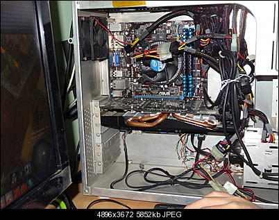

    I have 2 such rigs for my kids. They game and I don't. The only difference is that the other setup has a newer case. I think I have mitigated that with a new 120mm fan. In all, it has 1x120mm, 2x80mm at the front and 1x80mm at the back. The other rig is running quiet. Both kids playing Path of Exiles. The card is Powercolor PCS+ HD7870 Myst. Bought in Mar 2013. Just past its 3 year warranty. Sorry, I confused you on post #8. There is NO surrounding card.
    Maybe 2 pictures should clear things up.
ID:	37591Click image for larger version

  12. OK, well, I will make a wild guess that the card has not been doing this for three years, it likely started 2-3 months ago, and possibly has not gotten progressively worse over that time, while it would be useful to know these details, I have already shouted from the rooftops this question and got no useful information whatsoever, so I will have to use the crystal ball.
    Combining that guess with the large, heavy heatsink hanging vertically, plus the rapid rise in temperature in a short period of time, though AGAIN without a known quantity such as a benchmarking program to get repeatable results on more than one occassion, we have a one-shot occurrance with only a users estimate of time and temperature change, so once again the crystal ball comes out - remove, clean, re-paste and re-install the heatsink.
    Many cases have a series of holes in the side cover right near the video card, these are useful for mounting an internal fan in position to blow air FROM OUTSIDE THE CASE, as opposed to more hot air FROM INSIDE THE CASE, onto the card for the express purpose of cooling the card, that would be why I asked, TWICE, if any attempt to use this most simple and basic method of increased cooling for a high performance video card had been done.
    Also, temp monitoring programs are quite often wrong, and quite often dramatically so, would be useful to verify temp findings with a second program. That would be if you had some desire to make decisions based on precise, accurate information instead of guesses and estimations. Myself I prefer to have as much accurate, verifiable information as possible, this absolutely, positively leads to more reliable diagnosis and repair procedures, however sometimes you just have to work within the limitations of what is available.

    Hi Nelson37,
    Ran it without side penal(just like the picture) and the temp spike too. During the temp spike, and I use my finger to touch the heat pipe, it was real hot. Normally, the heat pipe is warm. I guess the temp sensor is working. I will reapply thermal paste and see how it goes.

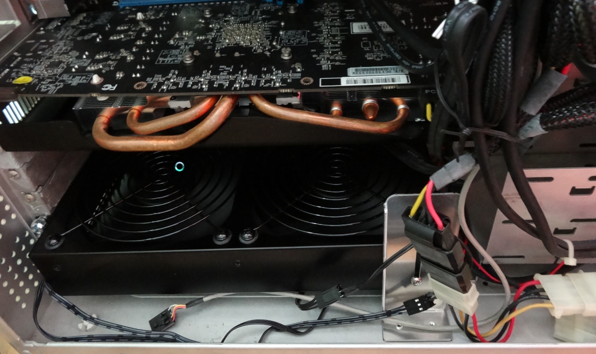

    But once I close the side penal, the gpu temp jumped from 74 to 82 degree Celsius.
    I think that the air circulation is bad under the gpu. So, I am going to get this.
  18. Member pchan's Avatar
    Mar 2003
    Singapore
    Here goes. With this thing (2x120mm fans), side penal is cooler.
    [Attachment 37717 - Click to enlarge]
  19. What are the temps with & without it ?
  20. Member pchan's Avatar
    Mar 2003
    Singapore
    Peak temp was 80+ degree Celsius without the pci slot fans. With the new fans, it seldom peaks at 80+.
    If you have noticed in the latest picture, I have moved the HDD up to floppy slot. The air flow is direct from the
    2x80mm fans in the front to the back.
