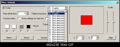

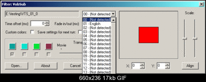

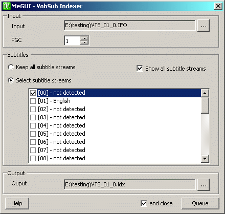

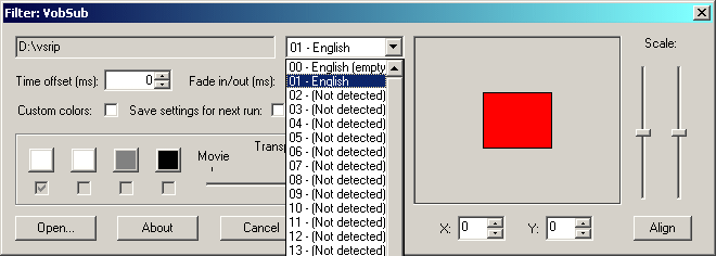

  24. Rewriting this post after a bit of experimenting......
    After discovering DVD subtitles can be muxed into an MP4 and doing a bit of experimenting, it seems there's an oddity relating to the way VobSubber extracts subtitles and the way MeGUI adds them to the command line for muxing in relation to the track number of the subtitle.... or something..... I'm not 100% sure yet. It seems though, automatically adding them via the OneClick encoder mightn't always work.
    When I opened the IFO file I was using for testing, vobsubber showed a single English subtitle stream numbered 01. When I checked the "show all subtitle streams" option there was a stream 00 listed, a stream 02 listed, a stream 03 listed etc, but all listed as "not detected".
    I extracted the single English stream and MeGUI used the following to add it to the command line for MP4 muxing:
    -add "E:\testing\VTS_01_0.idx#trackID=1:lang=eng:na me="
    There was an obscure warning in the log file about "track 1 ID not being found in file" and there were no subtitles muxed.
    I tried again, but rather than selecting the single subtitle when extracting, I checked "keep all subtitle streams" in VobSubber. Only the stream "01 English" was being displayed. After extracting I tried muxing again and MeGUI created the same command line. This time though, the subtitles were muxed and the warning was replaced with:
    VobSub import - subpicture stream 'eng'
    I don't quite understand what's happening. When opened with VobSubber, the English subtitle (and the only subtitle) appears to be track one (although the first stream could be track zero). When extracting by selecting the single English stream VobSubber, must extract it as track zero and MeGUI can't find it, although why it detects it as track one when adding it for muxing I don't know. I'm making guesses here.....
    The problem may have even happened at the ripping stage. When re-authoring, DVDShrink has a "logical re-mapping of enabled streams" option. Maybe that's got something to do with it (although I'm pretty sure it was disabled when I re-authored this DVD. Oh FFS..... I guess I should test it.....

  30. Here's all the the oddities I've discovered while playing around and the best workaround I've found so far at the end of this post.
    According to Vobsub and VSRip, there's two subtitle streams in the DVD files I've been playing with.
    Stream 0 and Stream 1. They're both English and as best as I can tell, exactly the same, so whether there's only one physical stream I'm not sure, but if I extract both I get a sub file twice the size as when I only extract one.
    VobSub and VSRip see Stream 0, but MeGUI's VobSubber does not. The lack of detection may be just a glitch in this case, but if I select Stream 0 for extraction it's successfully extracted and MeGUI can mux it. Had I not been messing around though, I wouldn't have known stream 0 actually contained subtitles.

    That oddity aside, if I only extract stream 1 with VSRip and open the idx file it creates with VobSub, it shows stream 0 as English but empty.
    When I extract only stream 1 with VobSub (MeGUI), it shows stream 0 as not detected.
    Either way seems acceptable on the face of it, and if anything the way VobSub extracts there'd be less ambiguity as to which streams actually contain subtitles.
    When muxing subtitles into MP4s, MeGUI always seems to specify track 1 in the command line (Stream 0 = Track 1 to MP4Box).
    -add "D:\VTS_01_0.idx#trackID=1:lang=eng:name="
    For the subs extracted by VobSub the problem seems to be obvious. MeGUI must simply assume the subtitles it's muxing are stream0/track1 and for the VobSub subtitles they doesn't exist. Specifying track 2 in the command line fixes the problem, but you can't make MeGUI do that.
    For the subs extracted by VSRip, Track 1's English subtitles are technically empty, but when track 1 was specified in the command line, the muxed MP4 appeared to have subtitles. Until the penny dropped and I realised MP4Box was foolin' with me and it muxed an empty subtitle track. English subtitles were showing up in the player menu but there were no subtitles to display.
    One way to solve the problem might be to not specify a track number, or specify track 0, which seems to mean all tracks. That'd fix the problem for subs ripped with VobSub but in this case for subs ripped by VSRip it resulted in two English subtitle menus in the MP4, but only one contained subtitles. It seems a bit silly of MP4Box to be muxing empty subtitle streams. MKVToolNixGUI ignores them.
    Ideally MeGUI should detect multiple subtitles from a single idx file and let you choose which to mux. Failing that you'd have to extract streams individually but at the moment unless they're stream 0 it appears MP4 muxing still won't work.
    When selecting "keep all streams" in Vobsubber it obviously extracts all streams containing subtitles and maybe the subtitles you were working with were similar to mine, so when you selected "keep all streams" it extracted stream 0 which appeared to be empty in the GUI but MeGUI was able to mux them. Based on my experience so far I can't think of another explanation for "keep all streams" fixing the problem. I wonder if MeGUI not detecting subtitles in stream 0 is a general problem, or just a glitch in this case? I probably should check later.
