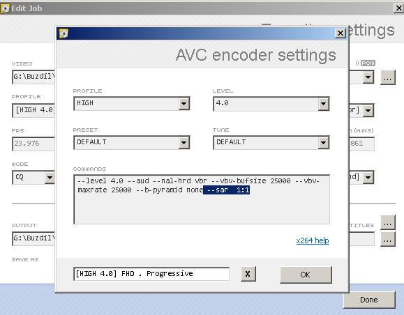

    You know AviSynth yet still use Handbrake? You could dump Handbrake and use a better program. For example, I use RipBot264 to open my AviSynth scripts and you can easily set the SAR to whatever you like:

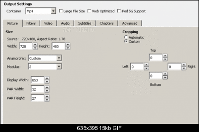

  12. Originally Posted by Downgraded286 View Post
    Could I set the aspect ratio in the Handbrake additional options box? That would make this a lot easier for me. I know there's a way to adjust it in the GUI, but it's... quirky at best.
    Theoretically Handbrake should make it hard for you to output a video without the correct aspect ratio, given it's designed to take care of it for you.
    This is the old version of Handbrake, but if you select "anamorphic custom" you should be able to set the pixel aspect ratio. This is how Handbrake version 0.9.9.5530 looks after opening a 720x480 16:9 video.

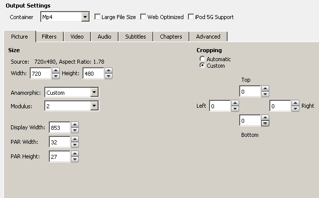

    I'll confess I don't fully understand how the various options interact, as I don't use Handbrake myself and the options can be contadictory in that they should effect each other (the display width should change the pixel aspect ratio etc) so some settings must take precedence over others. If you set them all correctly though, you should be able to set any pixel aspect ratio you like.
    For a 16:9 NTSC DVD the above settings will work, as long as there's no cropping or auto-cropping is disabled (otherwise you might need to change the resizing accordingly). Or....
    Clearing the resize fields and the display width field should let you simply set the pixel aspect ratio. Cropping on it's own doesn't change the pixel aspect ratio so with the other fields cleared you can set the desired pixel aspect ratio regardless of cropping. As an example, there's eight pixels cropped from the bottom of the picture in the screenshot below, the pixel aspect ratio is set to 32:27 and for an NTSC DVD that'd result in a resolution of 720x472 and a display aspect ratio of 853x472.
    That's what Handbrake should be doing for you when using "anamorphic loose" or "anamorphic strict" though. I'm not sure how or why you're managing to get it to output the wrong aspect ratio using either of those methods.

    According to MeGUI, which has a preset for the PS3 as a target playback device, the x264 command line requires this:
    --level 4.1 --vbv-bufsize 31250 --vbv-maxrate 31250
    Which means the PS3 supports Level 4.1 with extra bitrate restrictions, and Level 4.1 includes the decoding of 720p or lower at up to 68fps.
