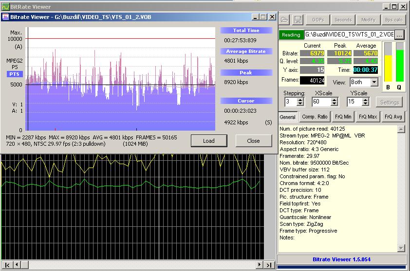

  12. Originally Posted by Noise View Post
    Here a log from Bitrate-Viewer:
    Wrong one. Your link leads to the Tecoltd Bitrate Viewer. There are, admittedly, two similar programs with the same name but my link above is to the one I meant, Bitrate Viewer. The one you used is not accurate for NTSC DVDs. Let me show you the differences. I opened the same VOB in both, one whose maximum bitrate I set at 9500. Compare average and maximum bitrates for the two.
Name:	Bitrate Viewers.jpg

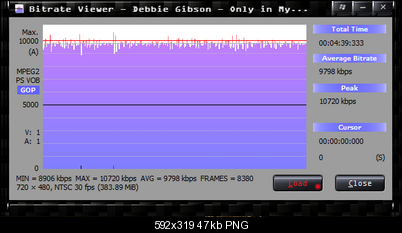

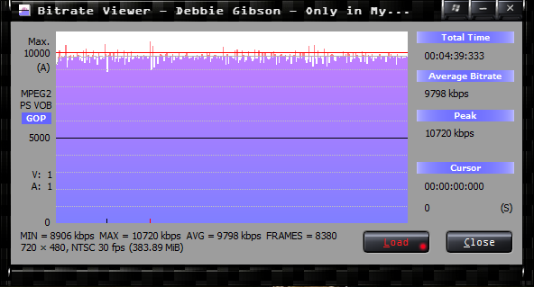

    Jun 2016
    Brazil
    My bad... I put link to wrong software.
    Here a print screen from the correct one:
Name:	Sem tÃ*tulo.png
  14. Well, if that one has PCM audio, then I have to eat my words. But it's non-compliant and you shouldn't try and copy things like that.
    You might try something to prove it to yourself. First, demux it into the video and audio. DGIndex can do that (Save Project and Demux Video). Or PGCDemux can demux it with the IFO as a source. Then try to reauthor it using Muxman which is strict about DVD compliance.
