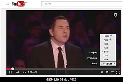

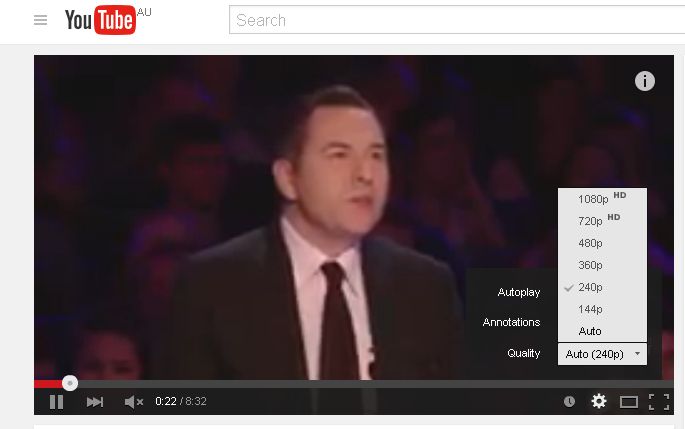

    Even in "pick your own quality" mode?
    I have a fairly slow ADSL connection and for me YouTube seems to start off in average quality mode, quickly dropping down to absolute crap quality mode, unless I manually specify a resolution.
