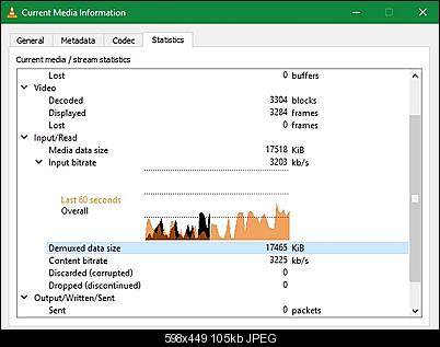

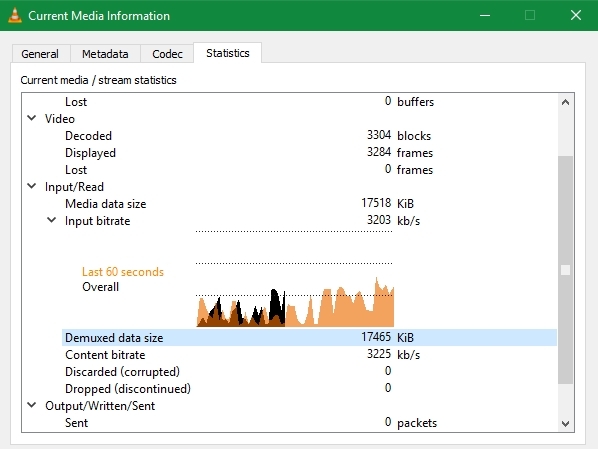

    Playing a Streaming Video on VLC
    i see the content bitrate 2500 kb/s while Demuxed data size is 14000 kb/s
    what is the difference ?

  4. Member Bernix's Avatar
    Apr 2016
    Europe
    I think the diference is in size of stream and uncompressed video, you see on the monitor.

  7. Member Bernix's Avatar
    Apr 2016
    Europe
    no content is original so 2,5 MB/s is video compressed and 14 MB/s is decompressed (demuxed -> in VLC)
    Maybe we think same thing

  8. I see, he's not demuxing the video stream, he's viewing the statistics dialog in VLC. "Content bitrate" is the bitrate at the current location in the file. "Demuxed data size" is the total data read from the stream since it started playing. Note the latter is not "per second" it's the total amount of data read.
