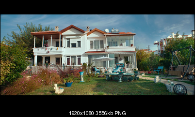

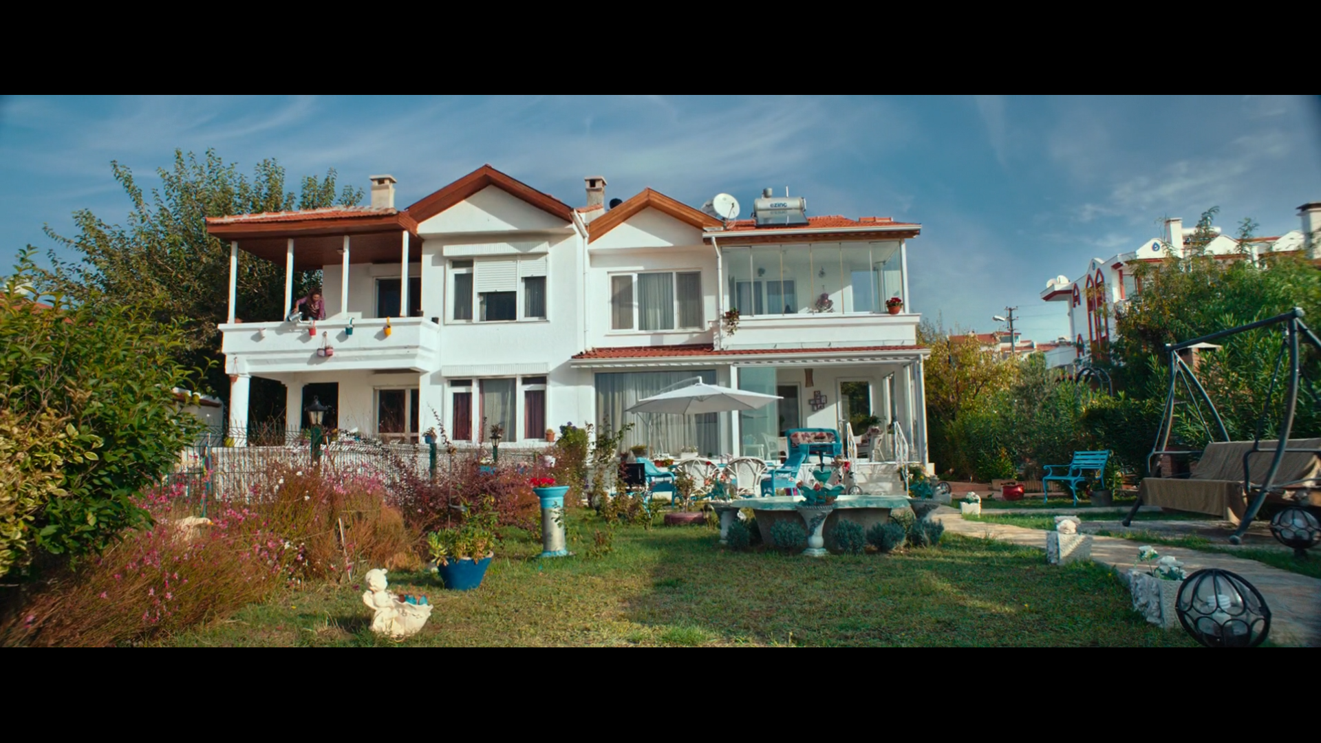

    And here is a good compressed movie example; 4,811 Kbps but looking better then 16 Mbps. How do they do it?
    Writing application; Mkvmerge. Should i use it for less kbps but good quality? And how can i find mkvmerge app?

  4. @Bernix thank you, yeah very fast option is not best option for quality i am using that option as slower or placebo.
    @theewizard Yes i know it but how people can do it? People compressing 2 hours long movies, videos to 2 gb or 4 gb and quality is really good. But if i compress a 10 minute long video even with 16 Mbps bitrate quality is not be like that movie samples...
    Are they using magic? Or which software? Everyone using handbrake or similar things like that? Is there any really good compressor, preset..etc can i learn?

  8. @KarMa @jagabo Thank you for spending your time to reply me.
    @jagabo You are really right. I am taking a shakey, bad equipment video but movie makers doing it with expensive equipments and with good technics.
    So compress procession is going better for that mo-pictures i think.
