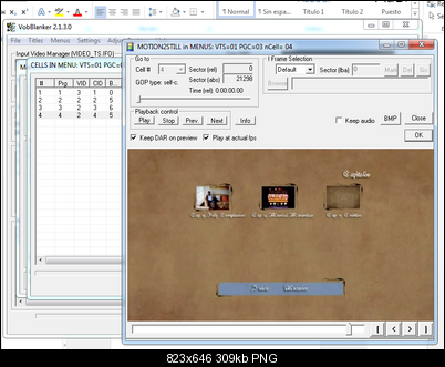

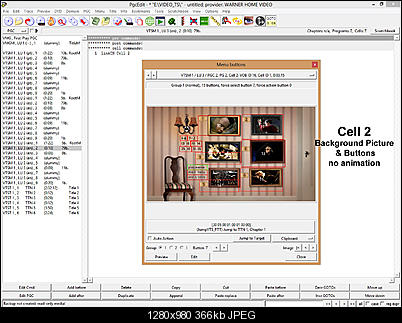

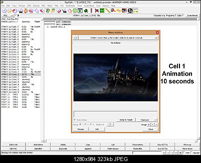

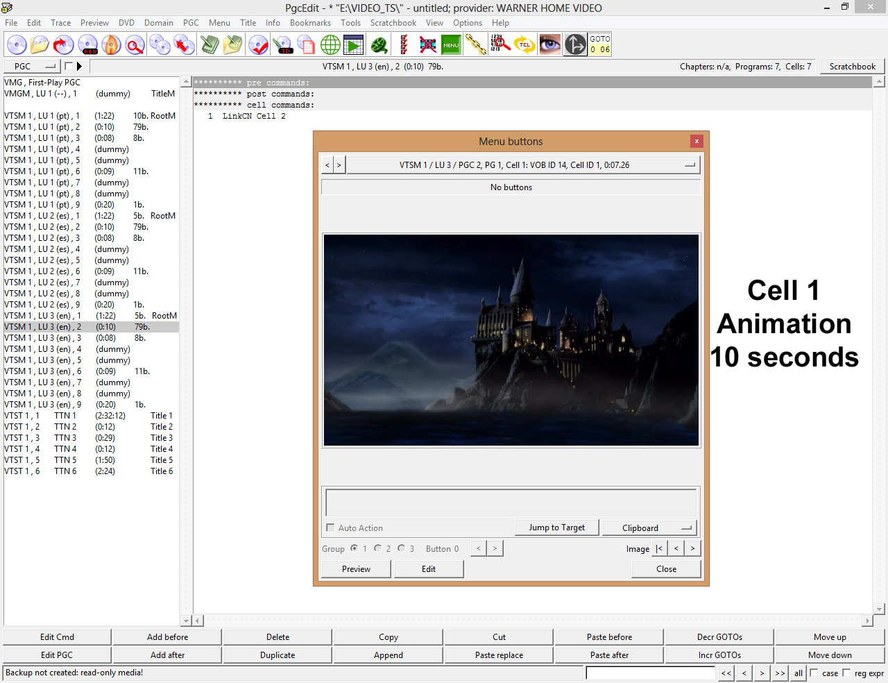

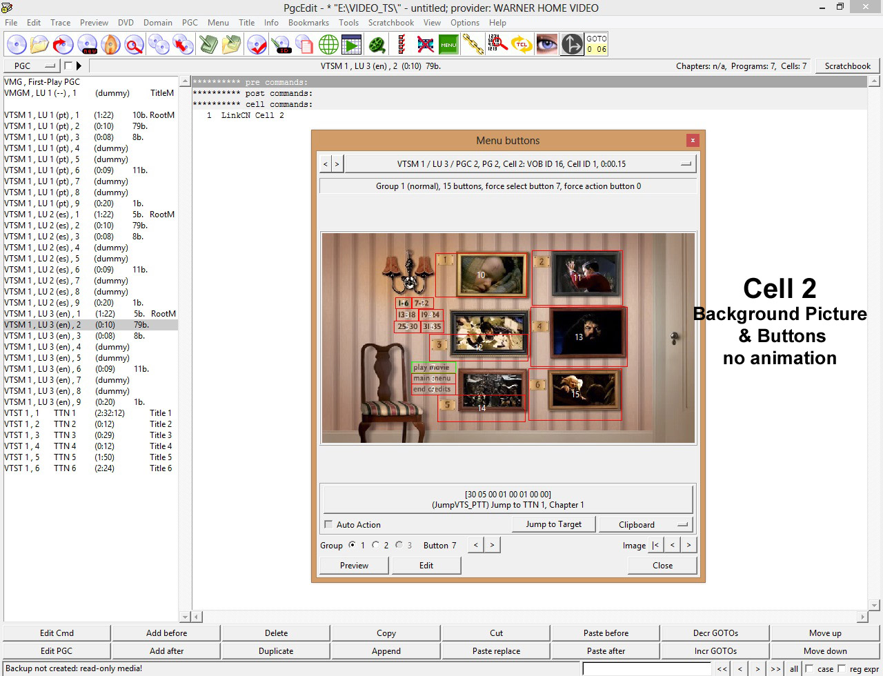

    Hello Everyone, I'm not talking about the main menu (MENU ROOT), I only speak of the sub menus, well, a small example of an original DVD would be Harry Potter and the Philosopher's Stone, because in the navigation options selection scenes, languages and special features, always have a small introductory animation with audio and video. And in the PgcEdit, animation is inside a cell, that this case is the cell 1 and the following would be an image with navigation buttons (LINKS), which is represented in the following figures:
    Cell 1
Name:	Photo1 - CELL1.jpg
    Cell 2
Name:	Photo2 - CELL2.jpg
    As it is the same Submenu be divided into cells as the first cell is a small animation and the next cell is a static image.
    Skiller friend said that before used DVD Maestro, PgcEdit and VobBlanker. In my case I am using DVDlab PRO and PgcEdit.
    Now, how would that same type of images but using the PgcEdit and DVDLABPRO?.... A little guide using these two programs
    Sorry for not responding quickly, I was busy.
    Sorry my bad English XD!!

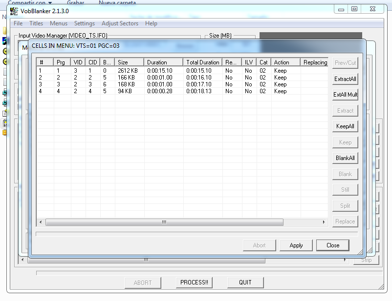

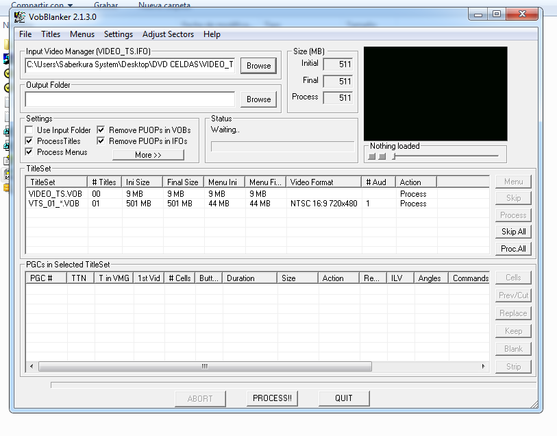

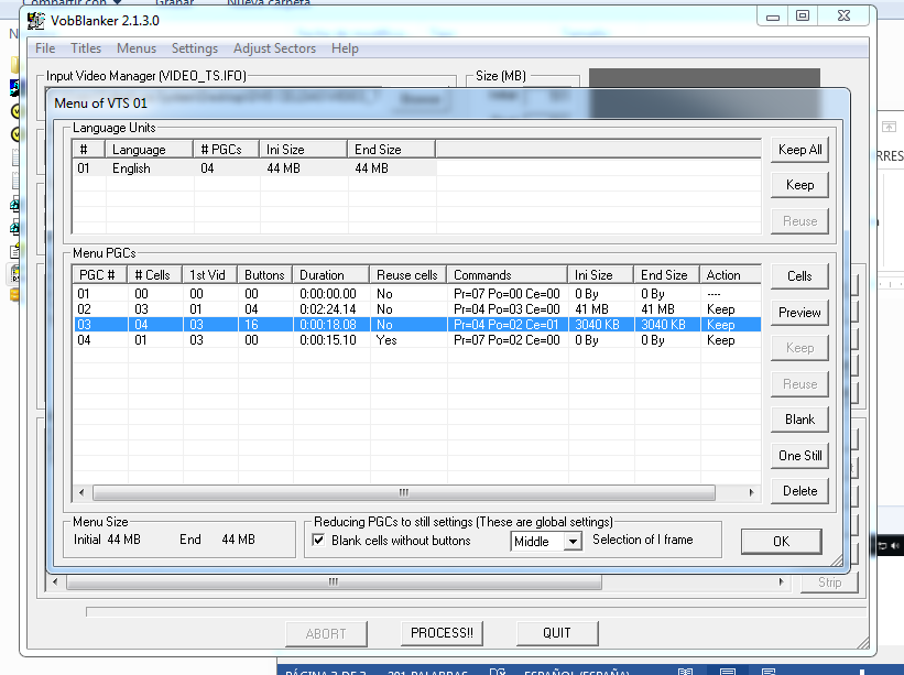

    These are the steps for VobBlanker:
    1) In the middle section mark the Title Set with your menu (like "VTS_01_*.VOB").
    2) Click "Menu" on the right.
    3) In the new window that pops up mark the correct language unit (top section), usually it's just 1 anyway.
    4) In the bottom section mark the correct PGC of your menu(s).
    5) Click "Cells" on the right.
    6) Mark Cell #2 (assuming Cell #2 is indeed the still part of your menu!).
    7) Click "Still". In the new window just klick "OK".
    8) Click "Apply", then "OK".
    9) "Process".
    Originally Posted by kirous View Post
    What if I forget to tell you that if at the point two, if more cells to increase menus with different static images, the process is the same ?
    Yes, the process is the same, except that the cell numbers of the menu PGC increase.

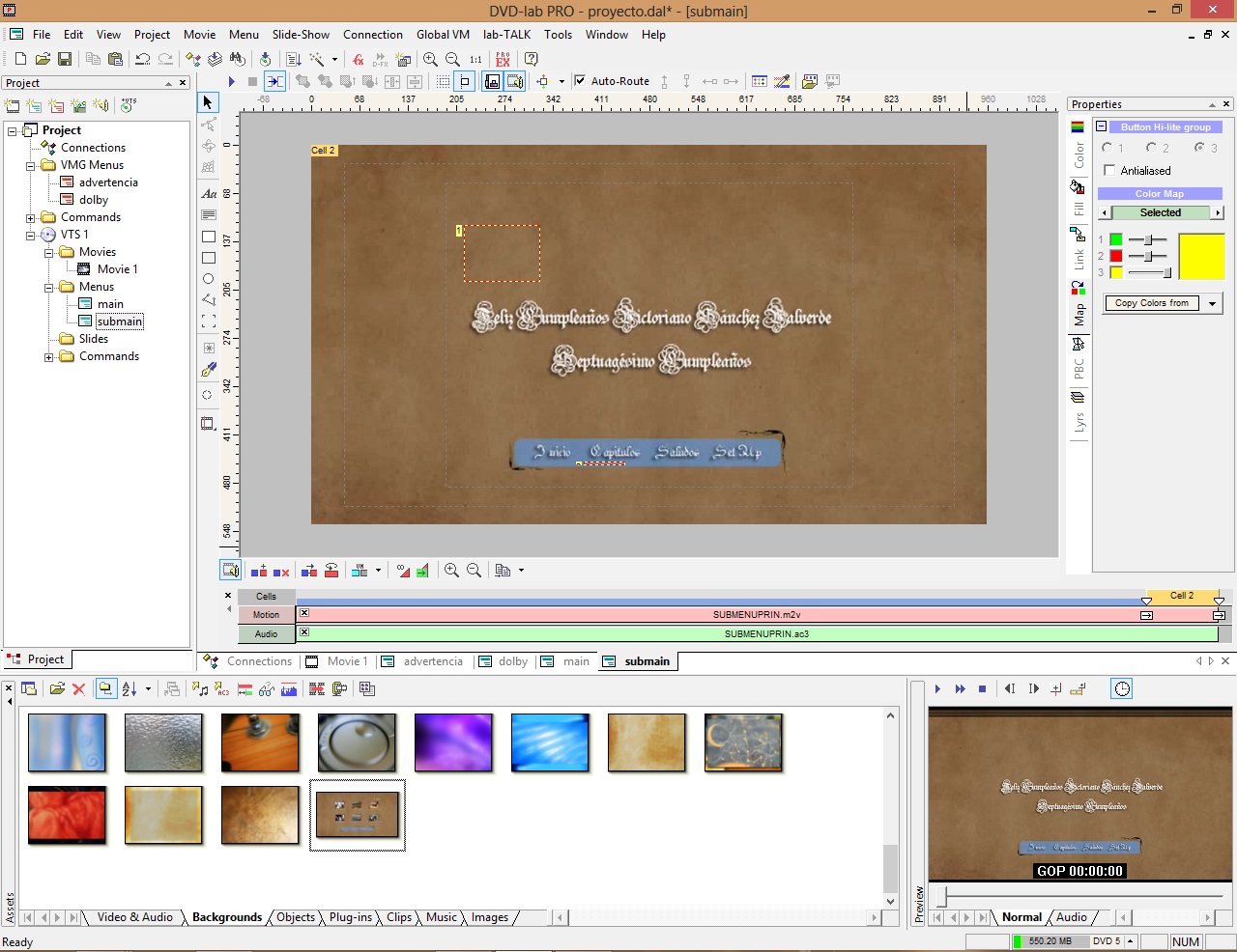

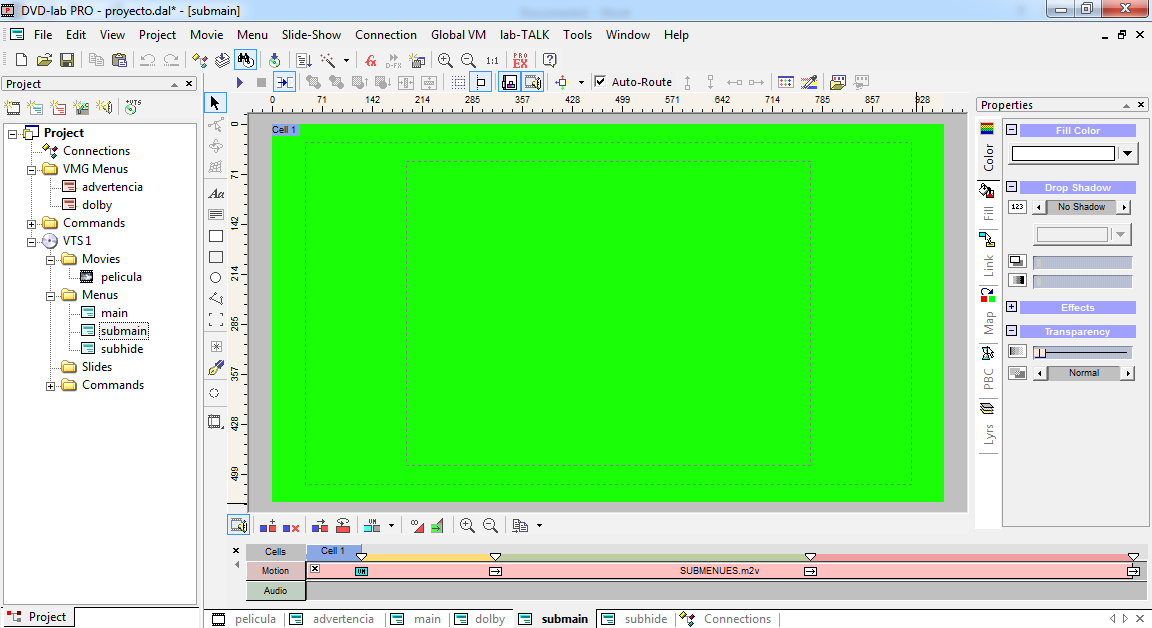

    Hello my friend Skiller, I did the steps, but still it does not work at all the "still". What if I'm in doubt it is about the audio as you mentioned me "only" file "m2v" but no "AC3" or other audio format.
    Look at a picture of my project, which is the sub menu, as this sub menu has animation for 15 seconds and 14 seconds appears the navigation buttons.
    I'm fine what I'm doing ?, because the whole video is 15 seconds long.
    Now when I perform the steps you mentioned, at the end, cell 2 is not static, it is played and returns to run from the cell 1 and so on.
    The question is: I did wrong ?, how can I stop this annoying reproduction, which should only remain "only" cell 2 and remain "static"?

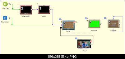

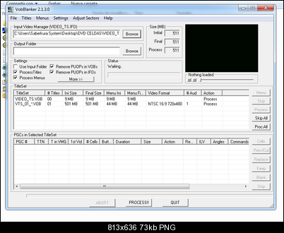

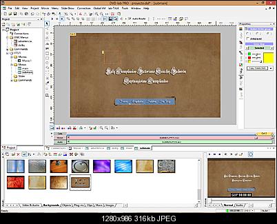

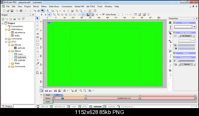

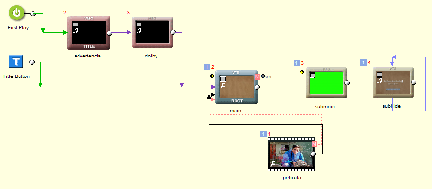

    Hello again, good still not solve this small problem, but I was investigating some steps and I am surprised that some cells do not belong in the same VTS, otherwise they are called "other" VTS that are "hidden" Or are in VTS created, for example in the audio submenu in one of the cells shared with the scene submenu, but if I tried to do it, doing these steps, for example:
    1.- In the first one is the topology, in this case, I made a VTS (SUBHIDE) more, which is going to call the submenu scene (SUBMENU) in cell 1.
    Note: in the VTS (SUBHIDE) the extension is in MPG and the VTS (SUBMENU) is in m2v.
    Here the contents of the SUBMENU:

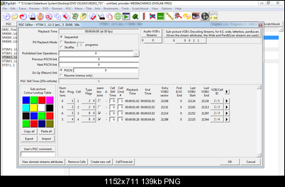

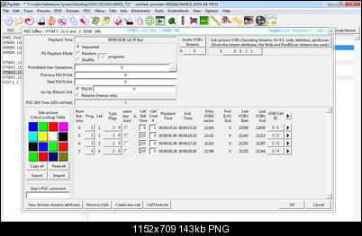

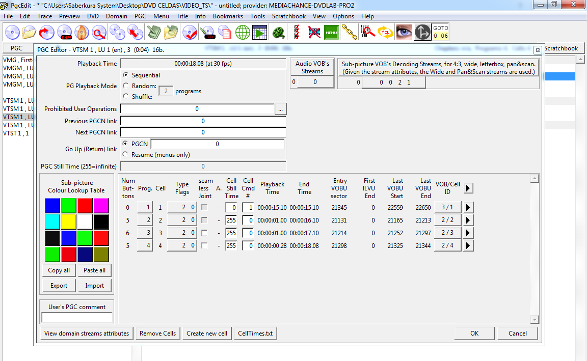

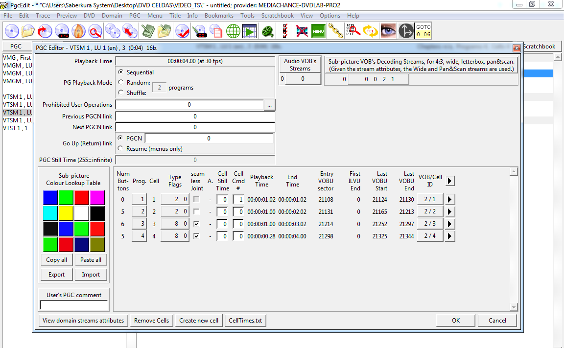

    2.- After compiling, change to PGCEDIT by double-clicking on VTSM 1 LU 1 (en) 3, and change this:
    For this:
    Note: the "Assign VOB / Cell ID for PGC Cell1", change from 2/1 to 3/1, since 3/1 would be the SUBHIDE.
    And once done I put "OK" and then save the whole project.

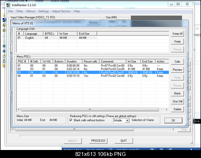

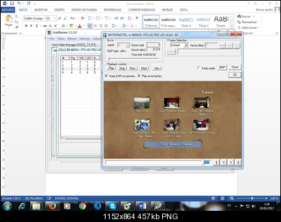

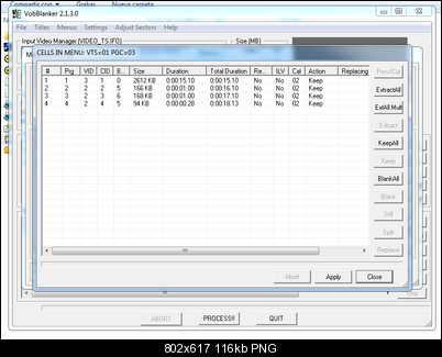

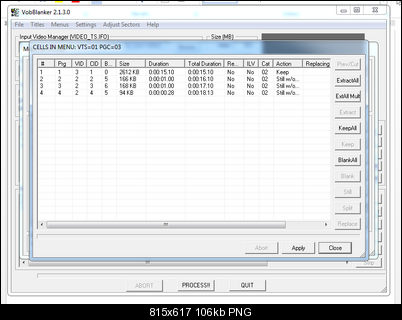

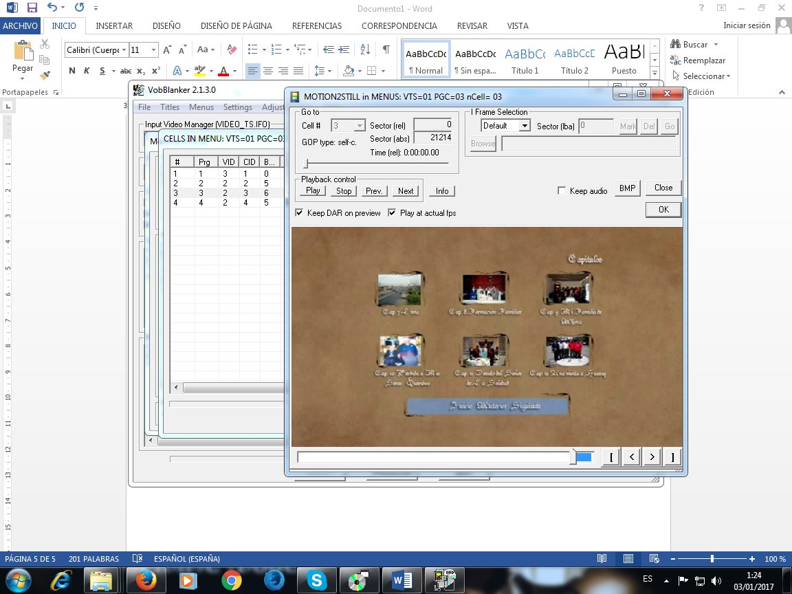

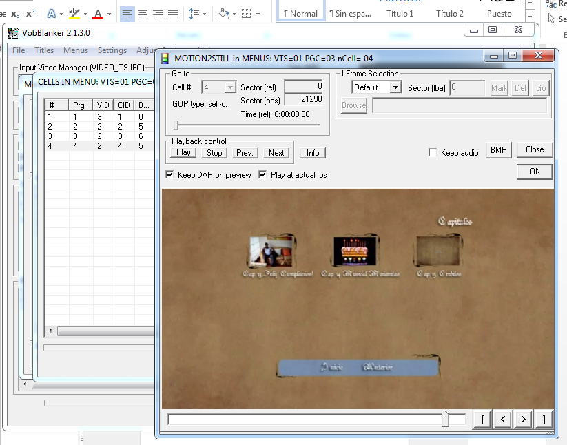

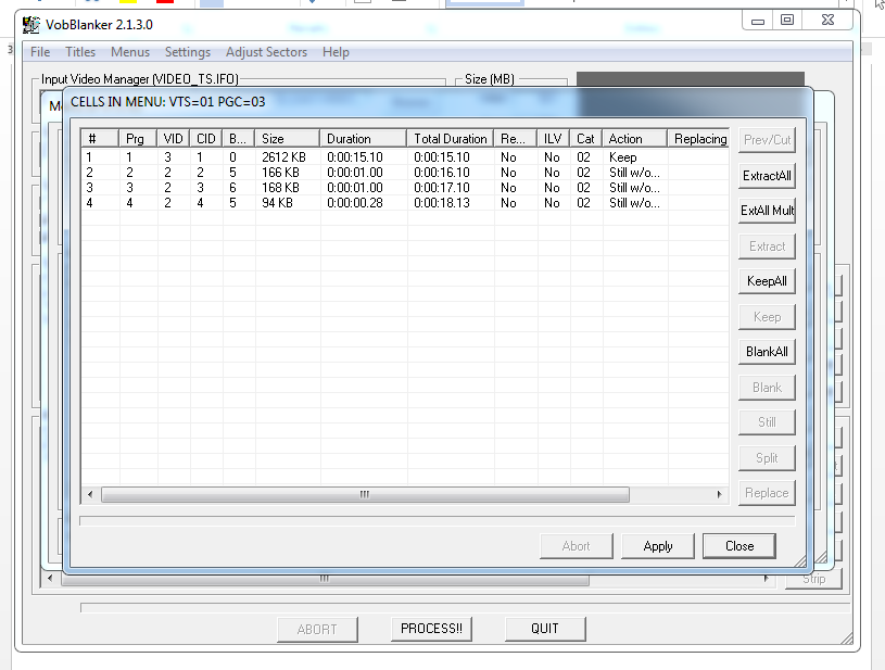

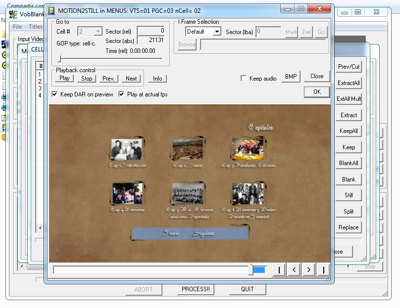

    3.- Then open the VobBlanker and I followed the steps according to the guide that my friend SKILLER gave me according to the images I show him.
    With this in the end I execute in "process", and then I test in both the Media Player Classic and Power DVD. And everything is fine.
    But when I burn to a DVD and put it in the DVD player, it starts normally, and when I choose the "scenes" option, the INTRO of cell 1 is executed normally until it goes to cell 2 that is displayed with the Navigation buttons, and now when you move to the next cell that is the number 3, it freezes everything and does not appear navigation buttons, they disappear.
    The solution is to return to the main menu as well as the Title button or Menu button and so again when choosing the "scene" option, the same problem is repeated.
    Well, it would be good to be told if what I am doing is right or wrong, or if not, if there is something to modify or add.
