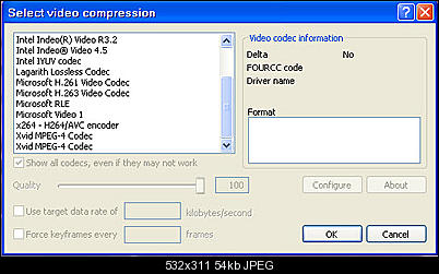

    I want to installing 265 for VirtualDub or VirtualDubMod
    Windows 7
    I want like this

    Thanks my friend

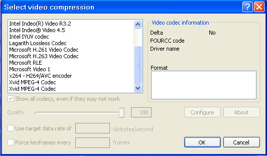

    [Attachment 37417 - Click to enlarge]
    Grab VirtualDub2 and x265VFW file.
    Link: https://sourceforge.net/projects/mpxplay/?source=navbar
    You can also link to external encoding and muxing software. You also have the option to use the Frameserver function.
