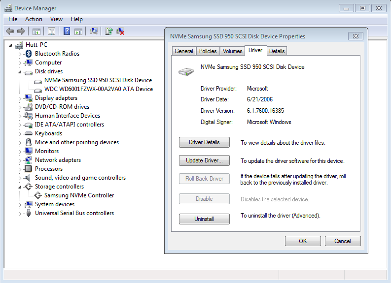

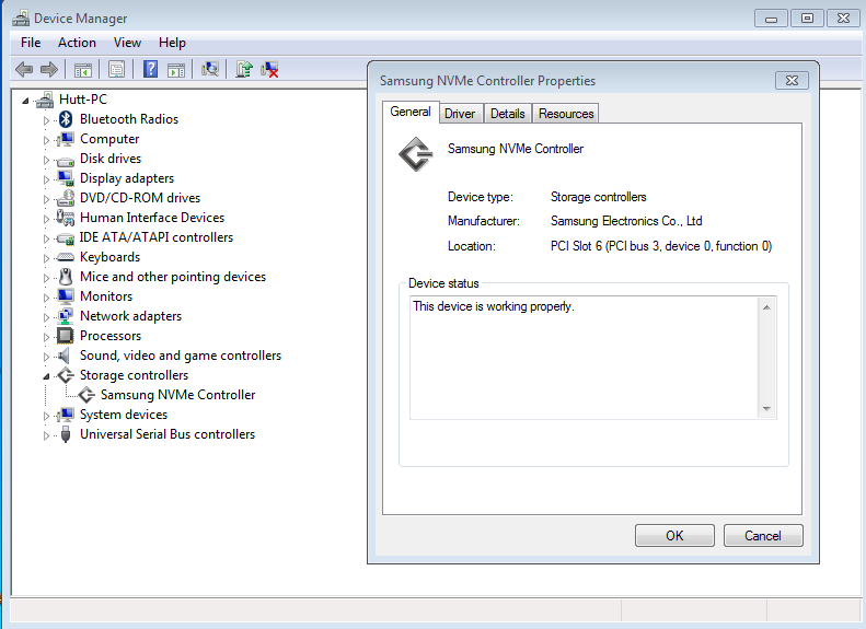

    Ok, I had a busy day today drinking beer on a boat so I didn't plan on getting to this... but when I saw your post I decided to mess with it a bit.
    Short story is Win7 has been installed directly to my M.2 drive.
    Long story is from your notebook review link I did the step formatting the thumbdrive and copying my win7 iso to it.
    The next step was to modify the W7 installation files... it provided a link but apparently this is for existing computers not a new build so that was the end on that tutorial for me.
    However scrolling down in the tutorial it speaks of loading the NVME drivers on the installation USB...
    Well I remember that when installing windows and getting to the screen where you pick your drive and format and so fourth there was a box to load drivers.
    So I downloaded this driver to a USB and loaded it up and it instantly recognized my M.2 in the windows install.
    However when I tried to install to that drive it told me
    "Window cannot be installed to this disk. This computers hardware may not support booting to this disk. Ensure that the disks controller is enabled in the computers BIOS menu."
    In reality I had no clue exactly what I was looking for in the BIOS at this point.
    Where it came from I have no recollection at this point as I've been to so many web pages for this my head is spinning but I had a little blue post it note sitting there and it said to do this....
    BIOS
    Boot menu>>> Compatibility Support Mode>>>Launch CSM = Disabled
    Secure Boot >>>OS Type = Other OS
    Key Management>>>Clear secure boot keys
    So I did the above.
    Booted into my flash drive with windows
    Get to the install... reload the NVME drivers again as they are gone after you exit windows setup.
    Select my M.2 drive and windows installs!
    So I'm quite happy about that... its way past my bed time and I'm going to sleep.
    On another note and quite ironically I think... I had stuck a HDD in there this morning before I left and was just going to install windows to it and using Samsungs Migration software clone to the M.2 later after the NVME drivers were installed.
    But I could not get Win7 to install to the SATA drive even though it recognized it with no issue.
    It told me that "setup was unable to create a new system partition or locate an existing system partition. See the setup log files for more information"
    So no idea what is up with that....

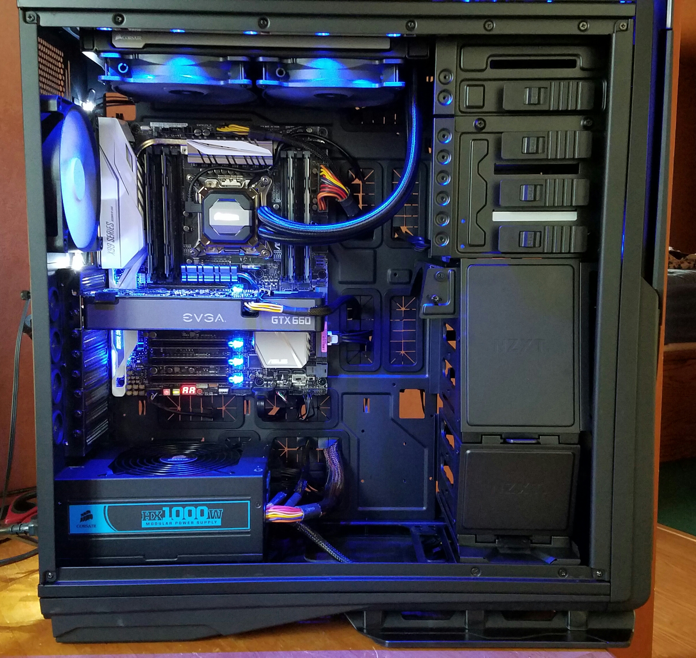

  9. Mod Neophyte redwudz's Avatar
    USA
    Post some finished photos, please.
  10. Member lordhutt's Avatar
    Jun 2004
    Well, pretty pictures may be all I get out of this damn thing... I'm back in hell.

    Heh, this is weird... after all this crap I just simply reinstalled windows from my dvd directly to the M.2 drive.
    I don't know if this had anything to do with the BIOS update or now.
    I didn't even have to manually load the driver this time when it came to selecting the SSD.
    Installed my drivers and windows is updating now...
    See what happens I guess.
    According to this guy though... even though its a different drive its still NVME.... he simply used the dvd as well

    So checking my drivers in device manager under storage controllers there is the smasung nvme controller with the driver I installed Image
    [Attachment 37935 - Click to enlarge]
    Under disk drives there is the samsung 950 and listed as a scsi drive with an old driver from microsoft 2006. Why is this listed as a scsi drive? Image
    [Attachment 37936 - Click to enlarge]

    [Attachment 37942 - Click to enlarge]
    Well, there she is...mostly together.
    As of right now I am totally unhappy with the boot speed. From a dead shut down I'm at almost 80 seconds. 36 seconds just to see the Windows startup. And there is no reason it should take another 40 to load Windows... I have what I'm assuming is the fastest ssd you can buy!
    My PC I want to replace with this boots in 60 seconds with a 10k rpm HDD so something is definitely wrong here.
    Especially with this being a fresh install with almost no programs installed yet.
    Samsung Magician reports good speeds so maybe it will run fast when its booted but I'm seeing people with SATA SSD's booting in less than half the time.
  16. Mod Neophyte redwudz's Avatar
    USA
    My PC from my Computer Details boots to the full Windows 7 64bit home screen in about 30 seconds. And the PC is loaded with files and programs.
    It booted much faster when the PC was first built and empty. My boot drive is a Samsung SSD 850 EVO 250GB SATA disk device and about 30% full.
    I keep it under 50% full max.
    The PC has 3 BD burners and 4 1TB WD Black drives and a USB 3.0 4TB external drive.
    The drivers for all drives are the ones that came with the MB, even for the SSD. AHCI is on for the drives.
    No idea why your new PC is taking that long. But it sounds like a program/OS load problem, maybe not the SSD.
    You can try selective startup and see if you can isolate the problem. Use the 'Windows' + 'R' key, then type ' msconfig '.
    This site may give you some more help: http://www.wikismarter.com/2014/09/how-to-run-selective-startup-in-windows_1.html
    But the PC looks nice.
