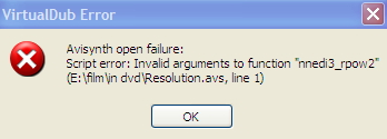

  9. Hello,
    the script returns the following error:

  10. Originally Posted by manono View Post
    If it isn't, give us the complete script and the complete error message.
    You only provided half of what was requested. Did you copy what jagabo wrote?
  11. Sorry! Yes, I copied that.
    The script is:
    nnedi3_rpow2(2, cshift="Spline36Resize", fwidth=704, fheight=576)
  12. Post your entire script. Do you have a source filter? Something like:
    ffVideoSource("filename.ext")
    Note that ffVideoSource() doen't come with AviSynth. You have to download and install it, just like you did nnedi3. If your source is an AVI file you can use AviSource() instead. Or you can try using DirectShowSource(). Both of those come with AviSynth.
  13. Hello,
    it worked ok with Virtualdub. Thanks.
