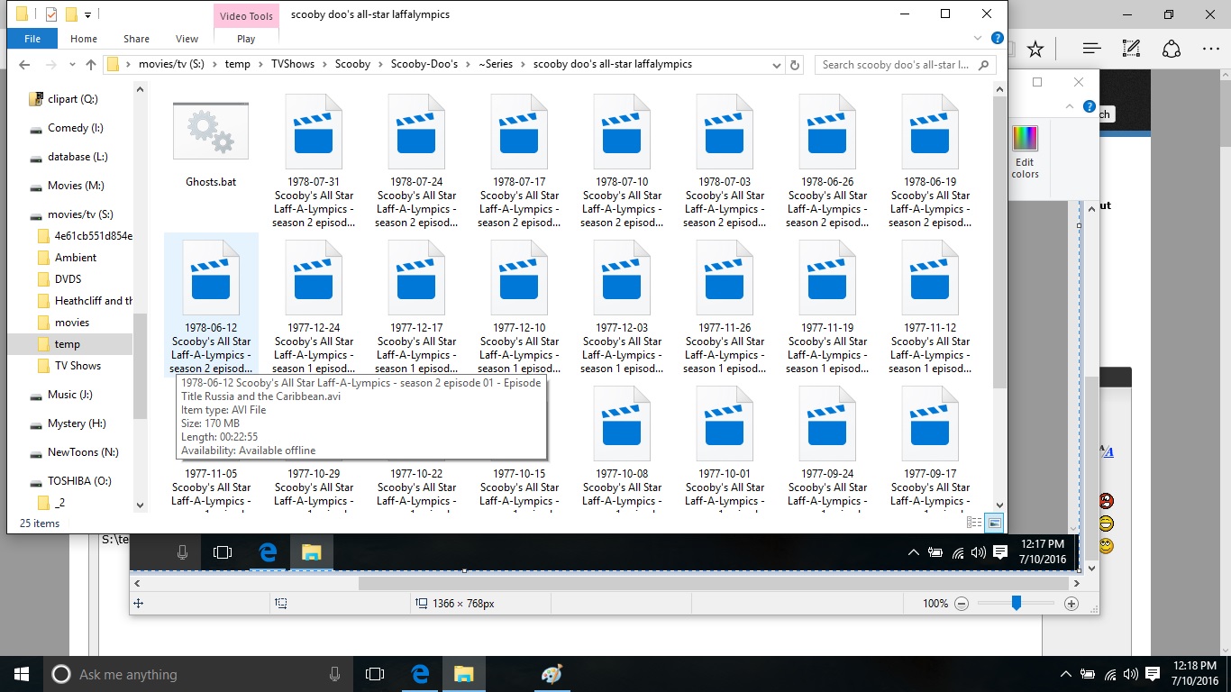

    AVI Files are in this directory:
    Same with Ghosts.bat
    S:\temp\TVShows\Scooby\Scooby-Doo's\~Series\scooby doo's all-star laffalympics
    All Files are AVI!
