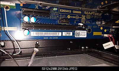

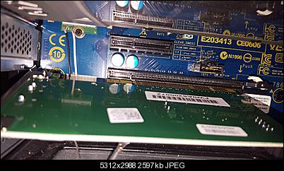

    Thanks all. I have a Dell Alienware Area-51 R2 and Dell has sent two cards that were supposed to fit - but they didn't.
    Here is one picture showing me trying to put in the card they sent (the 2nd one they insisted would fit) and another without the card. I was incensed at this point.
    I am just thrilled to have decent video now! It would have been wonderful to have better video but it seems these two remaining slots just don't work for what I need. The other two slots are taken up by dual NVIDIA 970 GTX cards in SLI.

  9. It looks to me like they sent you a PCI card, not a PCI Express card. Just go to newegg or amazon and order a PCI Express firewire adapter with a TI chipset.
    https://www.amazon.com/Syba-Profile-PCI-Express-Chipset-SD-PEX30009/dp/B002S53IG8/

    I downloaded the service manual for your Dell to look at the motherboard. The empty expansion slots in your picture are a perfectly normal PCI-e x4 and a regular PCI-e x16, with a normal orientation. Nobody would buy a Alienware PC if it were impossible to use the expansion slots for standard third-party add on cards.
    A PCI-e x1 card like the one jagabo linked to will fit in either of those. The connector on the card doesn't need to fill the entire slot. I have installed maybe 10 add on cards over the years. Sometimes I have had a problem attaching the bracket in the back of a case.
    The only questions are: Do you have to change any BIOS settings to use one of those slots and will populating either of them cause you to loose access to any other devices on the motherboard?

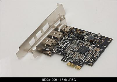

    Interesting. These are the ones that were sent and didn't fit. And I don't mean they didn't fill the slots, I mean they didn't fit at all; and as much as I sound like a noob I have installed a lot of cards myself. I may not know the specs well but I know when something doesn't fit.
    http://www.dell.com/en-us/shop/productdetails/341-1097 which clearly said it was compatible with my system (sigh) and then they sent it again (the dullards) but under the guise of a different code.
    Anyway, I am willing to give this a try, but judging by the photo, I think I will have the same problem getting the card in because the first connector looks too wide... I sure hope not though.

  17. Originally Posted by Aerroblade View Post
    It's not too wide. The pins on a PCIE card are smaller than the pins on a PCI card.
