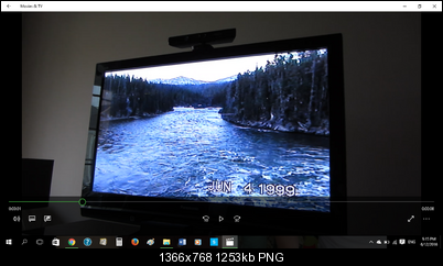

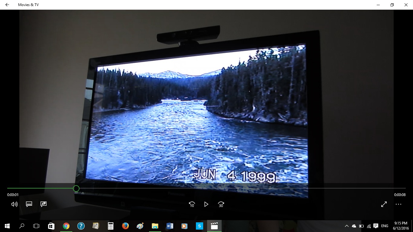

    The image below contains several of the thin horizontal lines. They are not so salient in a still shot but are very distracting on video.
Name:	horizontal lines.png
