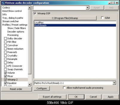

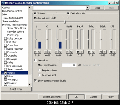

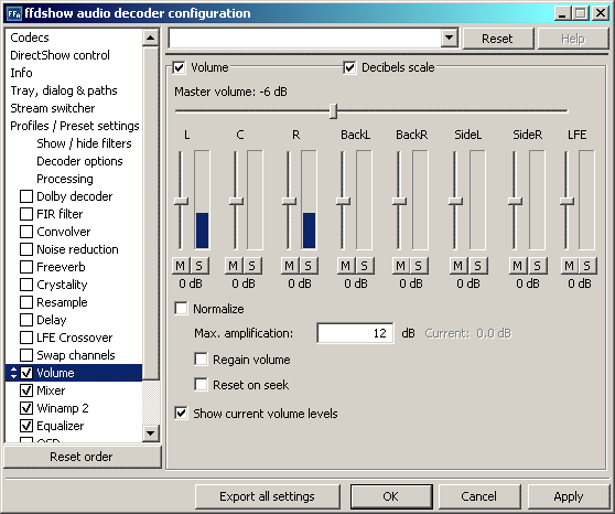

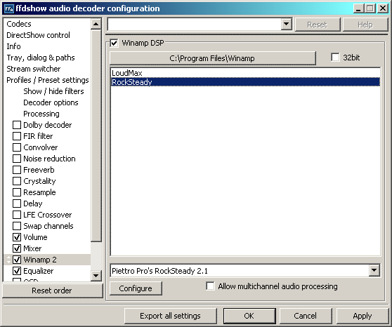

    As I said, I haven't used TomSteady, but I think that's what it does. I use MPC-HC myself so I use ffdshow to process the audio and load a similar Winamp compressor plugin called RockSteady. Potplayer has an option for loading Winamp plugins itself, so you should be able to achieve much the same thing without needing ffdshow to decode. I'm not sure what downmixing options Potplayer has but this is my ffdshow/RockSteady setup and I find it works quite well.
    You can re-order ffdshow's filters. I start with a 6dB volume reduction as it seems to allow a little more headroom for downmixing and the compressor plugin to work.

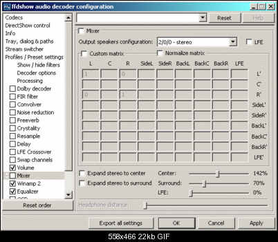

    Downmixing (accidentally disabled in the screenshot). The defaults for the faders at the bottom are all 100%. I boost the centre channel a little, reduce the surround channels a little, and disable the LFE channel completely. It really only boosts the low frequencies, which can interfere with the compression, and my sub speaker can still produce plenty of low frequencies without the LFE channel.

    Winamp Filter:

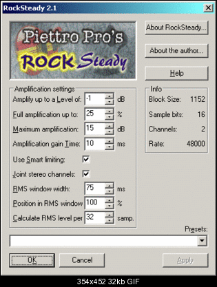

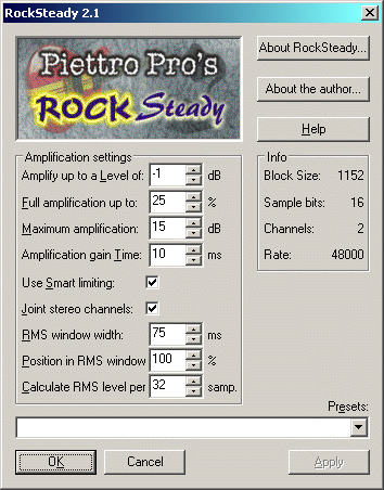

    My RockSteady configuration. It levels out the volume a bit without any noticeable "pumping", 99% of the time. Pumping is where the effect of compression is for background sounds to go up and down in volume as louder foreground sounds cause the compressor to work. That sort of thing. My TV has a "night mode" audio setting which compresses quite a lot, but there's "pumping" for days. For some reason I'm the only one who notices, but I find it distracting.
    An alternative to RockSteady is Loudmax. The WinAmp DSP version has nothing but a single slider. Don't let it fool you though, it's very good.
    Rocksteady only copes with stereo, 16 bit audio (which is fine if you always downmix as I do). Loudmax may work with multichannel audio without downmixing. I'm not sure as I haven't played with it for a while.

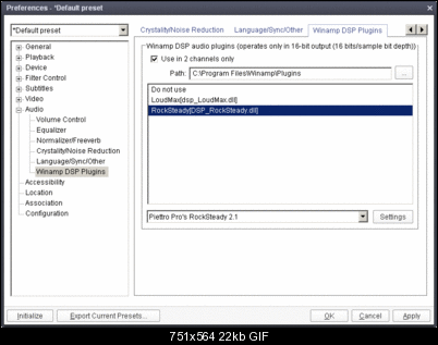

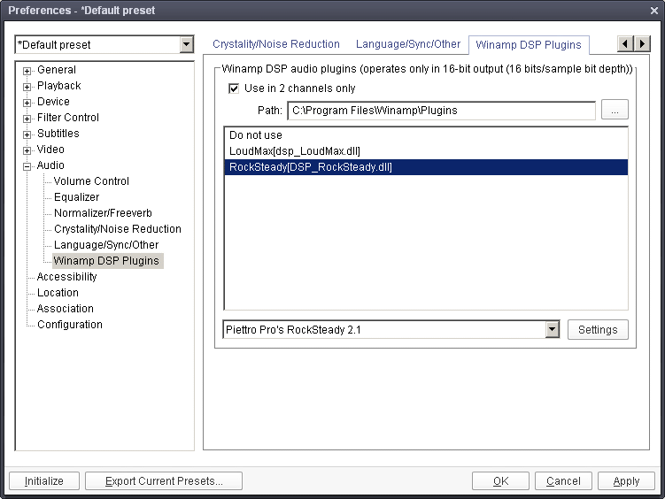

    How to get Potplayer to load WinAmp plugins:
    You don't need to install WinAmp to use the plugins. If you try any of that, please post back to let me know what you think.
