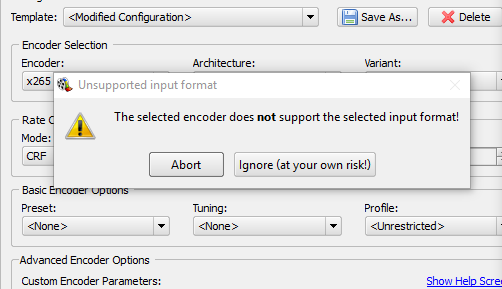

    I used help in my thread title because I am in need of help. It does this error whenever I switch it to x265 and try and start the encoding process. No matter what video format or movie I load into it it says the same thing every time.

    Everyone starting a thread is in need of help... Why else starting a thread? Mentioning the unsupported input format already in the title would have been a lot more useful, so that readers already know the core of the issue before opening the thread.
    I can confirm the warning. Please click on "Ignore" to run this job anyway, then show us the log in a CODE block here (right-click into the log, copy to clipboard).
    _
    P.S.:
    The reason seems to be that Simple x264/x265 launcher does not create an AviSynth or VapourSynth script to decode compressed video sources. The x265 encoder can only handle raw video (without or with YUV4MPEG header). Instead, x264 exists with included libav decoders from some builders. To convert source files like AVI, MP4, MKV etc. directly to HEVC, you cannot use Simple x264/x265 launcher.

    Here is the log.
    Simple x264 Launcher (Build #1026), built 2016-04-29
    Job started at 2016-06-13, 17:47:38.
    Source file : C:\Users\******\Videos\Marco Polo (2014) - 1x03 - Feast.mkv
    Output file : C:\Users*******\Videos\Marco Polo (2014) - 1x03 - Feast (2).hevc
    --- SYSTEMINFO ---
    Binary Path : C:\Users*******l\Downloads\Programs\simple_x264_la uncher.2016-04-29
    Avisynth : Yes
    VapourSynth : Yes
    --- SETTINGS ---
    Encoder : x265 (H.265/HEVC), x64, 8-Bit
    Source : Native
    RC Mode : CRF
    Preset : <None>
    Tuning : <None>
    Profile : <Unrestricted>
    Custom : <None>
    --- CHECK VERSION ---
    Detect video encoder version:
    Creating process:
    C:\Users\******\Downloads\Programs\simple_x264_lau ncher.2016-04-29\toolset\x64\x265_8bit_x64.exe --version
    x265 [info]: HEVC encoder version 1.9+140-34a3d35c5f97
    x265 [info]: build info [Windows][GCC 5.3.0][64 bit] 8bit
    x265 [info]: using cpu capabilities: MMX2 SSE2Fast LZCNT
    > x265 version: 1.9+140
    --- ENCODING VIDEO ---
    Creating encoder process:
    C:\Users\*****l\Downloads\Programs\simple_x264_lau ncher.2016-04-29\toolset\x64\x265_8bit_x64.exe --crf 23.0 --output "C:\Users\******\Videos\Marco Polo (2014) - 1x03 - Feast (2).hevc" "C:\Users\******\Videos\Marco Polo (2014) - 1x03 - Feast.mkv"
    x265 [error]: yuv: width, height, and FPS must be specified
    x265 [error]: unable to open input file <C:\Users\*******l\Videos\Marco Polo (2014) - 1x03 - Feast.mkv>
    PROCESS EXITED WITH ERROR CODE: 1
    Aug 2013
    Central Germany
    Thank you.
    As I already wrote in the "P.S." part:
    The x265 encoder cannot read directly from an MKV file. And the Simple x264/x265 Launcher does not create an AviSynth script to decode it.
    Use the Simple x264/x265 Launcher only for Y4M files, AviSynth or VapourSynth scripts. No other input will be supported for encoding HEVC with x265.

    If you don't want to mess with Avisynth then there is always Handbrake, which supports just about any video input and supports x265 encoding.
