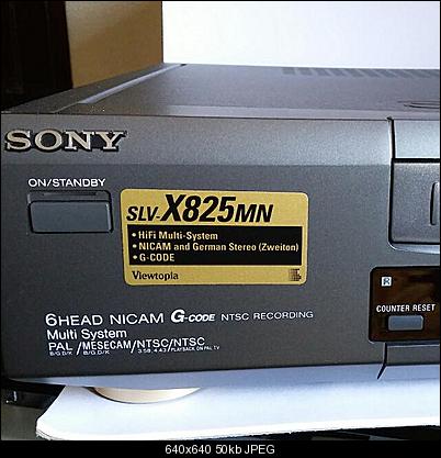

    if i get this vcr..
    does it may i can use either pal or ntsc tape?
  13. Member hech54's Avatar
    Jul 2001
    Yank in Europe
    Originally Posted by harky View Post
    if i get this vcr..
    You are not listening.
    EVERY PAL VCR allows you to watch both PAL and NTSC tapes on a PAL television....but
    the output signal when you play an NTSC tape is almost impossible to record/capture.
    EVERY PAL VCR is "multi-system" (as I just described above).
    The Sony VCR claims it can do more than a normal PAL VCR....but it also has the term "multi-system" on it.
    Is there any guarantee this Sony will output a true NTSC signal? I don't know.
    I spent years playing the "maybe this VCR will help me" game....didn't work.
    One last time......What you are trying to do is NOT EASY.

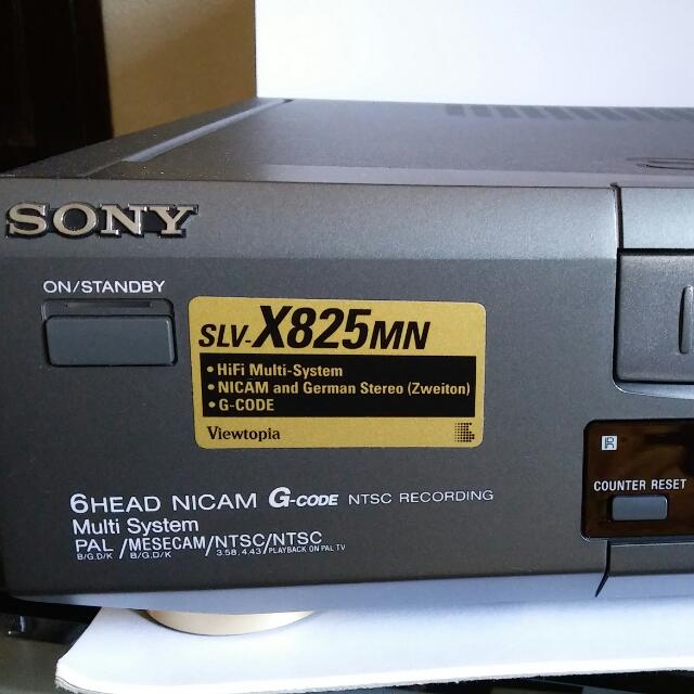

  15. Originally Posted by harky View Post
    alight.. than how do i know if the vcr is true NTSC?
    Under the NTSC label it says "3.58, 4.43". Those might imply that it can output either PAL60 or true NTSC. Find the manual and see if it has an NTSC output option (3.58 MHz chroma subcarrier).
  16. Member hech54's Avatar
    Jul 2001
    Yank in Europe
    All I know is that you won't find a true NTSC(only) machine that has SCART connections.
    If it has SCART connections....beware.

  19. Member hech54's Avatar
    Jul 2001
    Yank in Europe
    i dont think vcr come with any scart connections
    On the Sony VCR?
    The sticker says "German Zweiton".....that VCR has SCART connections.

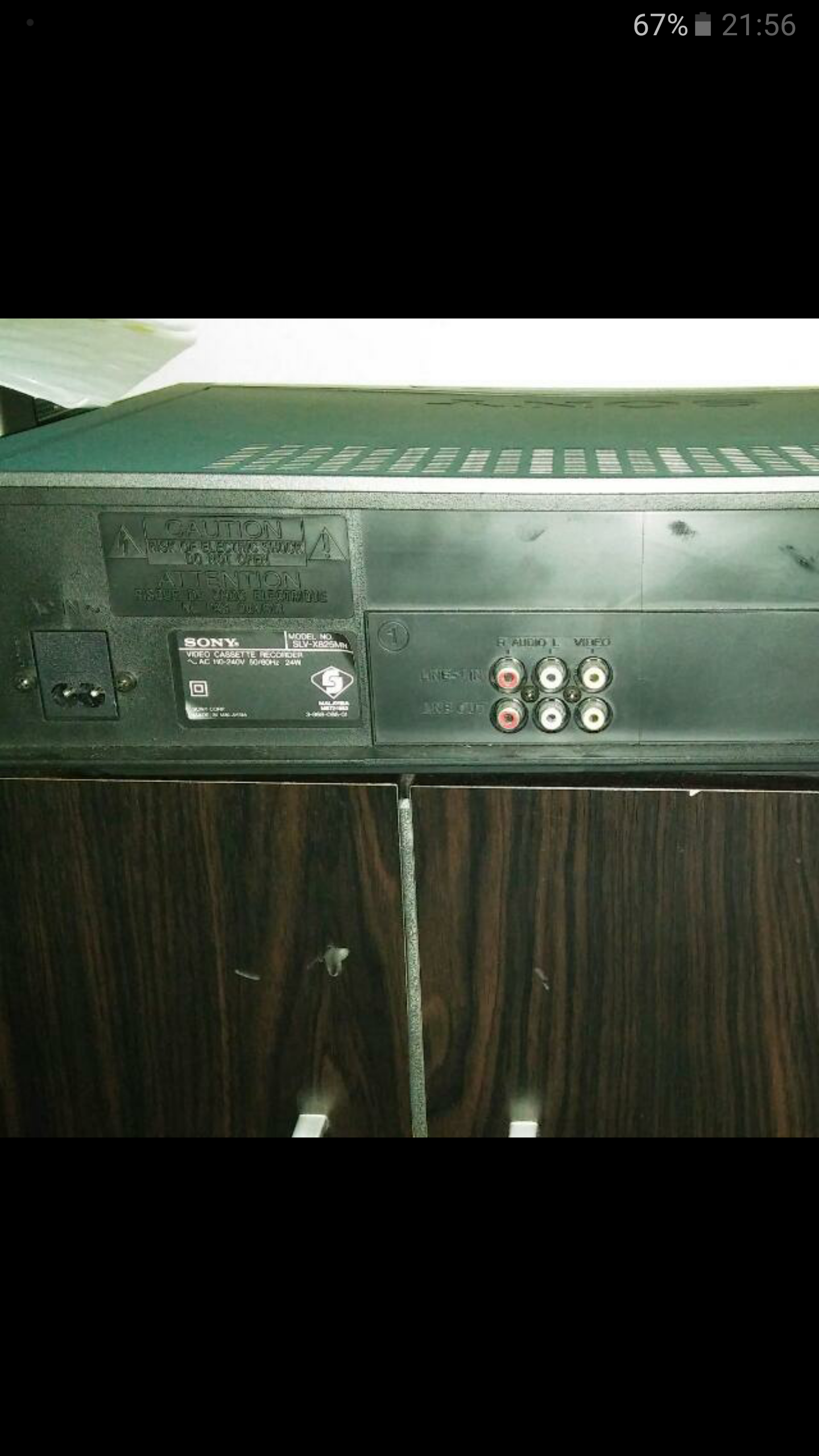

    Mar 2012
    Singapore
    i asked dont have SCART connections
  21. Formerly 'vaporeon800' Brad's Avatar
    Apr 2001
    Vancouver, Canada
    Set that switch on the back to NTSC 3.58.
    Also, LOL, a screenshot of a photo on your phone.

  25. Member Skiller's Avatar
    Oct 2013
    Germany
    NTSC PlayBack on PAL TV means PAL60 (and yeah, pretty much any European VCR has it), but that VCR has a switch to make it output NTSC tapes in NTSC 3.58, which is what you want. So go for it.
