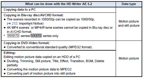

    Your camera seems to come with HD Writer AE 5.2 editing software? Did you check that out?
    And manono already answered about using DVD discs.

  10. Originally Posted by videobruger View Post
    And I'm too slow at typing.
    [Attachment 37232 - Click to enlarge]
    I'll take a look at the HD Writer. To be honest, as I do a lot of traditional photography, I have grown accustomed to ignoring the "included software" that comes with the cameras I purchase, as it is usually garbage. Perhaps this isn't the case with video.
