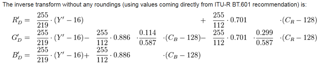

  2. Jagabo: where did you find these high-precision values on Wikipedia? I'm looking on the Rec 601 page and not seeing them.
    High-precision values for 709?
    // high precision values from wikipedia
    fr = (1.16438 * fy + 1.59603 * fv);
    fg = (1.16438 * fy - 0.391762 * fu - 0.81297 * fv);
    fb = (1.16438 * fy + 2.017234 * fu
  3. I think I started with this at wikipedia:
    Or maybe I actually found the equation somewhere else. I made the post a few days ago but it was actually a month ago when I wrote the program. I do remember finding some slight discrepancies at different sites.
