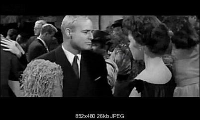

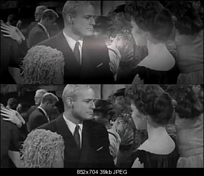

  7. Vignetting isn't hard to reduce if the picture isn't completely black at the edges. For example:
    http://rationalqm.us/hotspot/hotspot.html
    Maybe this is the type of thing you're talking about?
    https://www.youtube.com/watch?v=hRWbZ9HD4WI
    before/after:

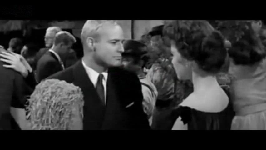

    The result of this improved script is slightly better than the script I used for the image I posted earlier. The black frame (spot/2) is slightly better (though still not perfect) than the one I used earlier and I cranked up the brightness to better match what I think the original was supposed to look like.

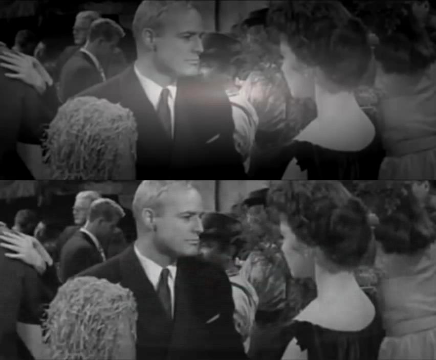

  13. I thought I'd give it a try myself, using the method I was thinking of. And it doesn't work. But masking can be used successfully, I think. Part of the problem is the guy that made the video using the method he did wound up crushing blacks in an oval around the outsides, so it can't be recovered properly all the time. I'd rather get the DVD if I was going to work on it. And as you discovered, jagabo (I think), fixing it as best as possible also requires going into illegal territory and then clipping to 16-235. With such a source it doesn't matter much.
    I got the mask from the frame number you provided. Thanks. And then tweaked it a bit.
    Anyway:
    FFVideoSource("1958 The Young Lions.mp4")
    Crop(0,64,0,-64)
    Spline16Resize(832,Height)###It's in the wrong aspect ratio on YouTube, I believe###
    A=Last
    Mask=ImageSource("Mask.bmp").ConvertToYV12()
    MergeLuma(A,Mask,0.36)
    SmoothTweak(Saturation=0,Brightness=-220,Contrast=3.1,Limiter=True)
    AddBorders(0,58,0,58)
    I saw the dot from time to time but would have had no idea what it meant if you hadn't explained it, jagabo. Did you figure it out yourself or did vaporeon800 provide you with the clue so you looked up a way to avoid YouTube's CID and then went from there?
