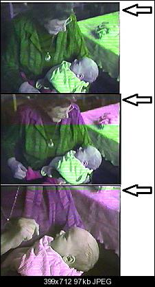

    I have a question regarding importing of VHS video through a USB/VCR port (European PAL VHS and VCR).
    I've imported several VHS tapes that have been completely fine (of adequate quality for my needs). However this specific tape has some problems during importing. The colors on the video on a large part of the image keeps flickering between green and purple (image part below the arrow on the attached image below). Only a few random scenes here and there are showing normal colors without flickering, put this changes even during the same scene.
    I know that the tape has been imported onto VHS from a video camera and later copied between two VCR machines to a new VHS. Unfortunately, I don't have the original VHS however.
    Does anybody know what to do to get a proper import or can this be corrected post-import?

    I've tried troubleshooting with what I've got, and found out that if I manually adjust/turn the wheel slightly, the colors get partially better (more passages without green/purple flickering). Could it be that the tape is not rolled up tight enough? My current VCR have a broken rewind function (it will only rewind while playing), limiting a fast forward/fast rewind.
  10. What "wheel" are you adjusting?
  11. I'm basically just winding the tape forward manually a few millimeters (i.e. turning the left (front view), white wheel counter-clockwise). Hope that makes sense.
  12. Oh I see: you are using the jog/shuttle wheel to slowly advance the tape while viewing the still or slow-motion video on your monitor.
    If this produces different color than what you get going full speed, then it does sound to me like it might be a tracking or alignment problem of some sort. Others here may have some additional ideas or insights into what else you might be able to do in order to capture the original color. Hopefully you'll be able to find that remote so you can experiment with the tracking adjustment while playing the tape at full speed.
