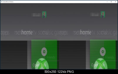

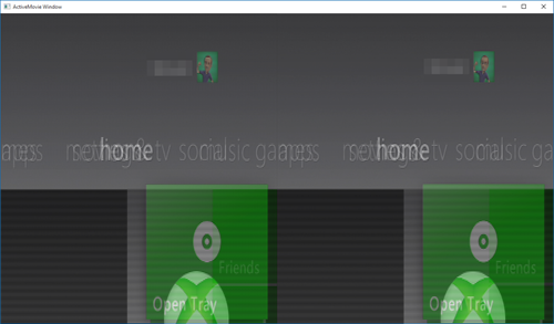

If I choose to transcode the video prior to streaming, the transcoding process adds latency (seemingly the same delay at any setting). I tried changing the resolution but seemingly it can only transcode at the source resolution of 1920 x 1080. When I set the resolution to be anything lower (I've tried about a dozen) and connect via the player or test within the server, the video is distorted as shown in the below screenshot. Anything lower I'd assume would need to be transcoded too so don't know if this would help anyways.
