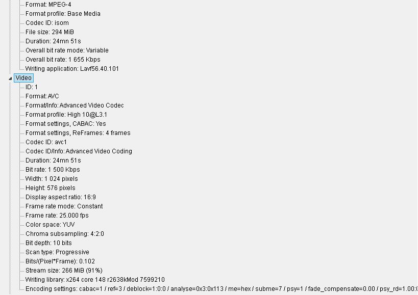

    Post the Mediainfo of one of the files with the problem.
  3. Ok details of original file in attachment
    MediaCoder settings when re-coding
    Rate Mode: average Bitrate
    Format: H264
    Container: mp4
  4. Dinosaur Supervisor KarMa's Avatar
    Jul 2015
    US
    Probably because the video is 10-bit instead of 8-bit.

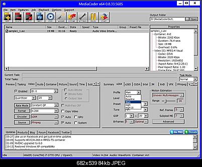

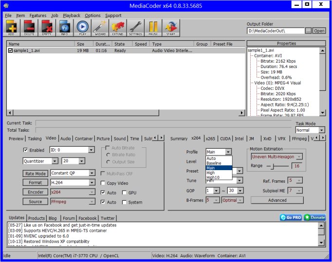

  6. Guess there is no way to adjust this in MediaCoder when re coding?
    Just don't use High10 (or Auto) as Profile.
  7. Hooray, it worked
    Looks like you were right changed profile from Auto to Main and re-coded all the prob files and now all are fine with thumbs showing.
    But just shows you as kind of novice with these complicated progs all it needs is one thing to be incorrect and process is buggered.
    But thankfully solved now and another item added to the learning curve
    So thanks for advice, saved a lot of hassle!
