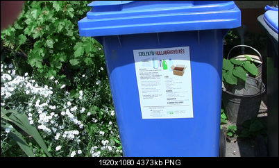

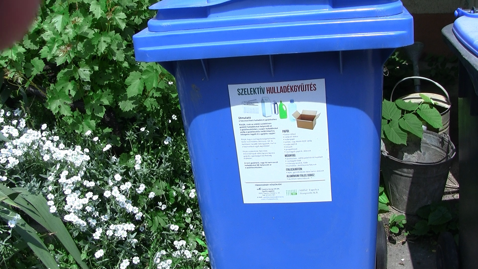

    Camcorder: Canon HF G25 PF25.
    HDMI recorder: AmarecTV
    I can't see any real difference between lossless UT Video (4:2:2 REC 709) capturing via HDMI cable , AND AVCHD PF25 in max settings 24Mbit/s
    How is it possible?
    video snapshots were uploaded, the first HDMI lossless 4:2:2, the second simple AVCHD 24Mbit/s 25fps

  3. The HDMI cap is sharper and has more fine detail. Use a screen magnifier like the one that comes with Windows. Look at the small text and the veins in the leaves. Some of that could just be a sharpening filter.
    Look for a scene with a lot of complex motion. Differences may be more obvious there.
