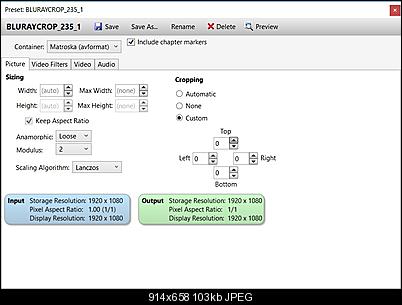

    I believe this ocurrs due to some incorrect VidCoder manipulation, I mean: I'm afraid, that all downloaded mkv done with VidCoder, or all mkv I've recoded (due to file size, in order to fit it onto BD25) have something (headers, video format or whatever I don't know) that do not adjust to bluray standard and the Samsung player refuses to play (although it recognizes and try to load the discs, notice that).
    I hope you could help me. Thanks.

  8. Ok it works. BDtoAVCHD is a valid option. I've also reached VidCoder configuration parameters that gives a BluRay compliant source for direct muxing. I've noticed that there is a new amount of time for encoding due to the cropping of the video to a compatible resolution. Here's what I'm using in VidCoder to get it:
    Next taxes: Obtain fully compatible BD9 BluRay and obtain main forced subtitle for BD25.
    Thanks a lot!!!
