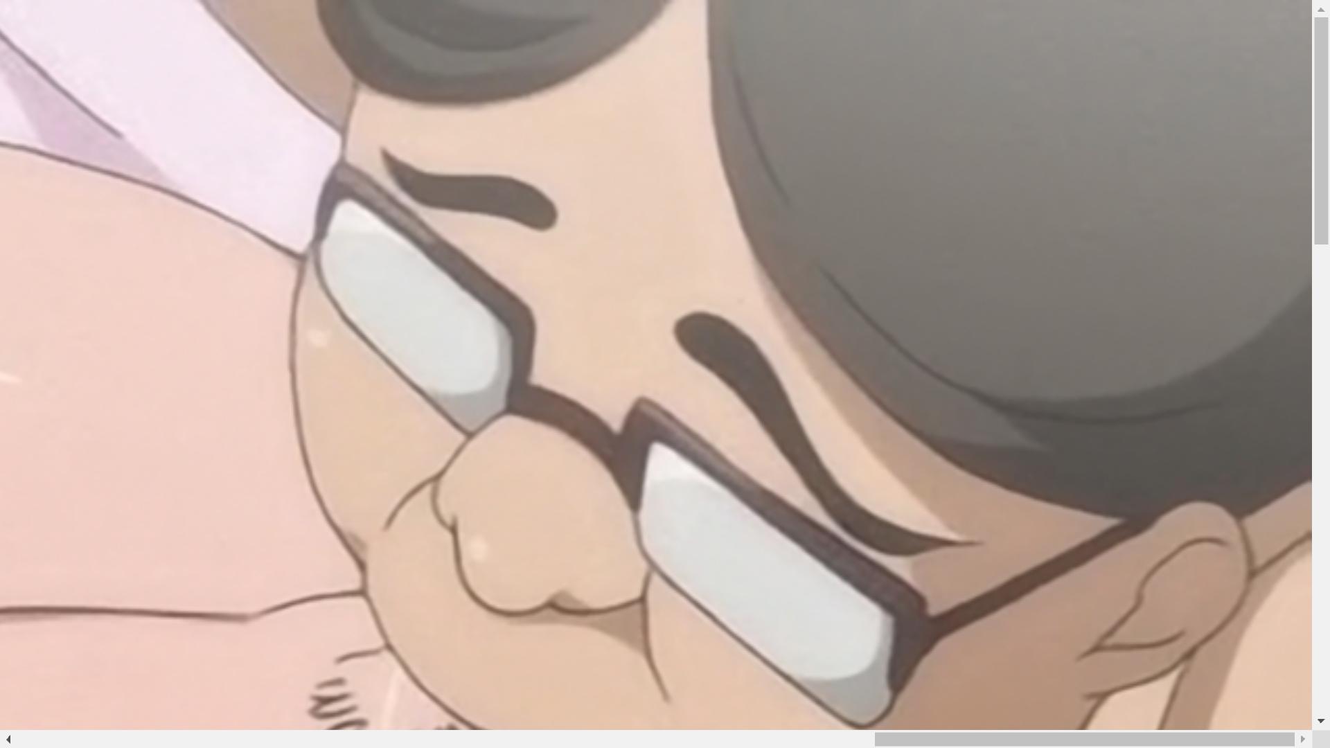

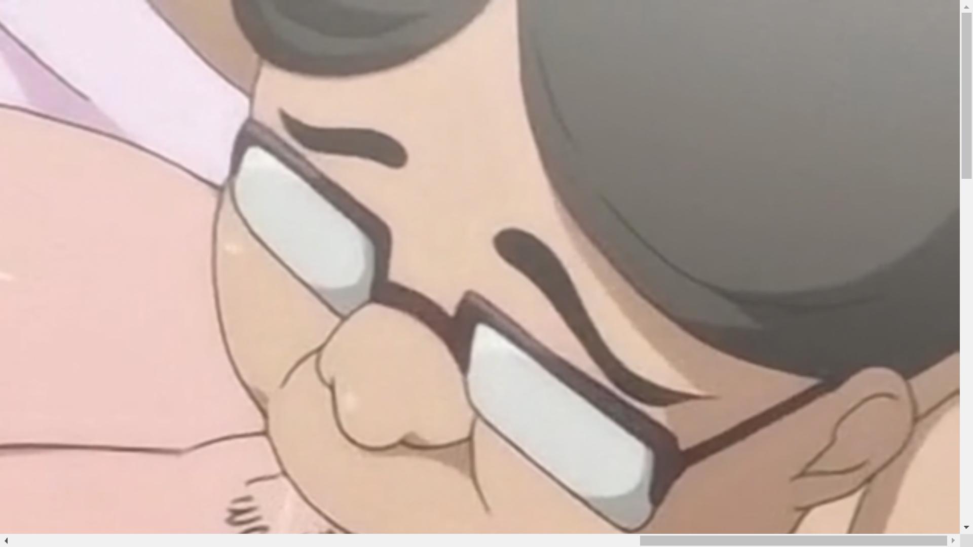

  1. what causes this stuter with a simple script like this
    https://forum.videohelp.com/images/imgfiles/QvMhEUN.jpg
    https://forum.videohelp.com/images/imgfiles/3EQSq0W.jpg
    v = LWLibavVideoSource("d:\4.mp4", fpsnum=30000, fpsden=1001, format="YUV420P8")
    a = LWLibavAudioSource("d:\4.mp4")
    AudioDub(a,v)
    ConvertToYV12()
    ColorMatrix(mode="Rec.601->Rec.709")
    ColorYUV(cont_u=20, cont_v=20)
    nnedi3_rpow2(2, cshift="Spline36Resize", fwidth=1280, fheight=720)
    i guess it doesnt take the source really well
    any suggestions?
  2. Stuter? You mean stutter? How can one see stutter with two still frames? What are the two images showing us?
  3. Originally Posted by jagabo View Post
    sorry that i wast clear do you see the difference in the images?
    they are identical exept one is the original and one is encoded by the script you see how it resulted in some kind of back ground noise and became less clear
    that is what i am asking
    for example look at the glasses
    after the encode they became like less straight i can say
  4. But the output screenshot is not directly from the script, is it? You probably encoded using a lossy encoder (x264?) that introduced additional quality loss - that's what lossy encoders do. If you want less quality loss you need to put in more bitrate and/or CPU time (different preset or even x265) and/or otherwise better tuning.
    Of course your process is questionably anyways. You aren't really filtering out any artifacts. It's not worth re-encoding that way IMHO.
  5. Originally Posted by zanzar View Post
    Stutter is term related to motion as such single picture can't have stutter at all - it is static...
  6. So the first image is the original video upscaled to 1920x1080 by the player and the second image is the video upscaled to 1280x720 via nnedi3, encoded with a lossy codec, then upscaled to 1920x1080 by the player? I'd agree with sneaker, you made no attempt to reduce artifacts in your source so they were accentuated by the first upscale. Then the encoding was at too low a bitrate for the material, generating more artifacts. Then player upscaled and accentuated the artifacts even more.
    In the future it would be better if you uploaded a sample of your source, and a sample of your final video.
    i now see that if i mimp up the bit rate like to 3000 in x265 it looks better
    also how do i remove some of the artifacts and why are they caused?
    why if i put it trough the encoder and spit it out at the same bit rate why doesnt it come the same?
    sorry i really dont know about this stuff
    thank you for trying to help me
