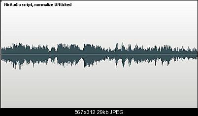

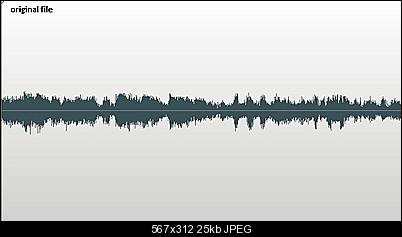

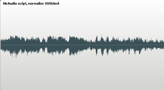

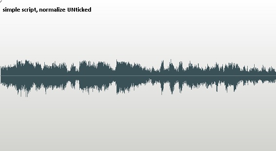

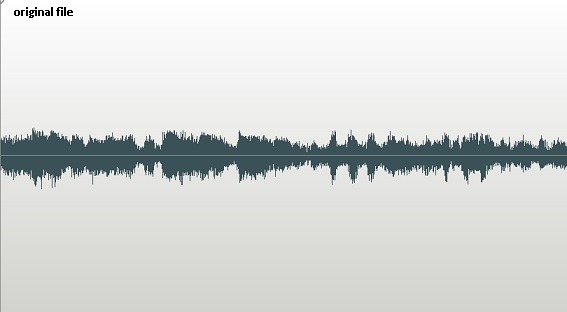

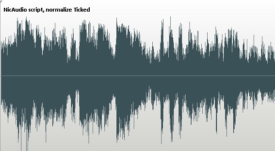

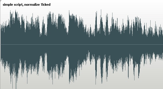

  8. hello_hello once said about a rogue file “I couldn't let it win”. That's now how I feel about the Amplify() function. I've been trying to get it to work using scripts without any other filters to get in the way. I've used the very simplest script:
    LoadPlugin("E:\MeGUI port\tools\dgindex\DGDecode.dll")
    DGDecode_mpeg2source("E:\mel.d2v")
    Amplify(0.2)
    And a script using NicAudio:
    LoadPlugin("E:\MeGUI port\tools\avisynth_plugin\NicAudio.dll")
    video = DGDecode_mpeg2source("E:\mel.d2v")
    audio = NicAC3Source("E:\mel T80 2_0ch 384Kbps DELAY 0ms")
    AudioDub(video,audio)
    Amplify(0.2)
    I've run each script twice – with and without the 'Normalize Peaks to 100' box ticked. As you can see, no success. Even the smallest of the new waveforms are slightly higher than the original.
    I've attached the clip for anyone who has the time and inclination to have a go producing a working script. If you do, you have my thanks.
Name:	a5Nic Untick.jpg
ID:	37052Click image for larger version
ID:	37053Click image for larger version
ID:	37054Click image for larger version
Name:	a3Simple Untick.jpg
ID:	37055Click image for larger version
    Aug 2013
    Central Germany
    So how did you decode the "original" script? Which decoder was used in your "reference"? And why did it decrease the volume unnecessarily? And how much?
    I wonder if that decoder used the very pessimistic approach to decoding AC3: It may have up to 6 channels, and each of them may have 100% volume at the same time, so let's divide the sum of all channels by 6 (1/6 ~ 0.166...). A certainly wrong calculation for a 2-channel source. And even for a 6-channel source, there are much more reasonable assumptions (e.g. assuming phase differences in surround effects, a division by √6 is almost safe).
    By the way: Your "simplest" script loads no audio track, therefore it outputs silence. I don't know where your audio output comes from in this case. Possibly the auto-generated audio script which cannot be found outside MeGUI (except in its log file).
  10. I demuxed the audio from your sample, loaded it into the audio section and set the encoder to normalize peaks to 50%. The encoded audio was quieter than the original. From the log file, this is the script MeGUI created to encode the audio (behind the scenes).
    LoadPlugin("C:\Program Files\MeGUI\tools\avisynth_plugin\NicAudio.dll")
    NicAc3Source("D:\mel T80 2_0ch 384Kbps DELAY 0ms.ac3")
    # detected channels: 2 channels
    # detected channel positions: 2/0/0
    Normalize(0.5)
    return last
    I tried again loading this script into the audio section instead of the original file:
    Amplify(0.5)
    return last
    When I checked the log file, the Amplify option wasn't listed because the log file only shows the imported script, not it's contents.
    Import("D:\mel T80 2_0ch 384Kbps DELAY 0ms.avs")
    AudioBits(last)>24?ConvertAudioTo24bit(last):last
    return last
    It did work though. The encode via the script with Amplify(0.5) was quieter than the encode using Normalise (0.5) in the encoder configuration, and they were both quieter than the original. I didn't check with a cuts file loaded, but I can't imagine why that'd make a difference.
    In case you're wondering about the 24 bit output, it's probably because I test encoded with FLAC the second time. For the lossy encoders it might be 32 bit float, assuming the encoder supports it.

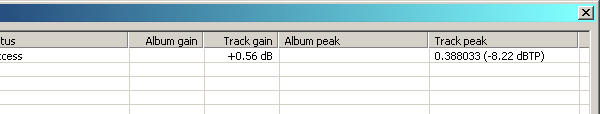

    If you want to try foobar2000 for audio encoding at some stage I can help you out. It's more fun than MeGUI in one respect.... if you load multiple audio jobs foobar2000 will encode as many simultaneously as you have CPU cores until it's done. MeGUI encodes audio one at a time. And there's all that indexing.....
    Foobar2000 can't do the traditional "normalise peaks to maximum" thing itself, but there's a plugin that lets it open AVISynth scripts, so you can still peak normalise with AVIsynth if you're into that sort of thing. If you use QAAC for encoding it has a peak normalising function of it's own. Foobar2000 can dowmix multichannel audio, but I'd recommend using the third party Matrix Mixer DSP rather than the built in foobar2000 downmixing DSP, because then you have total control over how audio is downmixed.
    Most importantly, foobar2000 has a ReplayGain scanner. It'll scan and save the info to the files so you can adjust the volume accordingly when you encode. There's also a way way to use the ReplayGain info to do peak normalising if you really prefer it. The volume of MP3 and AAC audio can be adjusted losslessly so for those types you can encode first, scan second.
    About the only thing I haven't quite worked out is how to scan multichannel audio with ReplayGain when it'll be downmixed. Well... it's easy to do, but if you downmix the audio the volume will probably change. I don't know if there's a way around that. I don't do much downmixing these days so if I do I just downmix and encode to a FLAC or wave file, scan that with ReplayGain, save the info, then re-encode to the final format while adjusting the volume. Unless the output will be MP3 or AAC because then you can encode first, scan and adjust the volume second.
    Oh.... and obviously Foobar2000 can't load the cuts file, so you need to use MeGUI for that part.

    Good morning hello_hello and thank you very much for all that effort. Using your method of loading a purpose-built script into Audio Input, I managed to get a low-volume file but only with 'Normalize Peaks' unticked. With it ticked, the volume is increased dramatically.
    It does seem, though, that this page is completely incorrect, the Amplify() command just doesn't work as simply as they suggest:
    http://avisynth.nl/index.php/Amplify
    Amplify should work as described, but it won't work with the Normalise option enabled in the audio encoder configuration.
    Remember.... there'll be two scripts involved if you don't load the audio directly. The one you created for loading the audio into MeGUI (with Amplify included), and the one MeGUI creates behind the scenes for encoding, using your script as the audio source.
    Your script might lower the volume with Amplify, but MeGUI's Normalise option will add the normalising to it's script, so effectively the volume is reduced by your script and then it's probably increased again. In your case the Normalising option would win because it's being applied after the Amplify option. You'd end up with the same volume as you'd get with just Normalising enabled and without Amplify being used at all.
    Once you've "not let it win" it'd probably be easier to load the audio directly and use the peak normalisation in the encoder configuration to adjust the volume. Assuming the peaks are already at 100%, normalising the peaks to 50% should reduce the volume by 6dB. If they're not already at 100% the volume change might be less, or it could even increase, so it'd require a little trial and error, but you probably have to trial and error a little using Amplify too.

    Originally Posted by pooksahib View Post
    As you can see, hello_hello, I'm sticking with Amplify() rather than playing about with Normalize Peak. It seems the 'proper' way to do it.
    Neither method is correct or wrong as such. Amplify just increases or decreases the volume according to the amount you specify. Normalise adjusts the volume so the peaks are at the level you specify whether it needs to be increased or decreased, which is why it's traditionally been used to make the volume of different files "roughly" the same.
    Both are the equivalent of throwing darts at a dartboard compared to ReplayGain/128Gain if you want the level of different tracks to sound the same. After scanning a file with ReplayGain you're provided with details like this (foobar2000's scanner in this case):
    The level displayed for "track gain" tells you how far off the target volume you are. You don't even have to know what it is as it's an industry standard volume (there's actually two commonly used volumes, one for standard CD tracks and a slightly lower one for soundtrack audio). It also tells you what the peak volume is. From there, MP3 or AAC can be adjusted without re-encoding (with the right program). For other audio types you can automatically adjust the volume when converting.
    If you want to have a play at some stage, maybe try this program. It might provide a more visual representation of how the system works, although it's dog slow compared to foobar2000's scanner. Even my old PC can scan an MP3 at about 150x "real time" if it's over-sampled for "true peak" level, and about 400x "real time" without over-sampling, and by default it'll scan four files at a time (4 core CPU).
