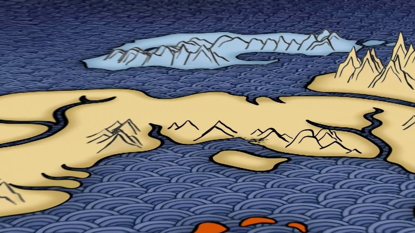

  1. I'm new to the world of encoding and H.264, so please go easy on me.
    I've decided to encode my blu-ray library into MKV containers for portability purposes, however, I'm getting far too many artifacts on the encode as you can see below:
    Original
    Encode (x264 - Handbrake & MeGUI - both 10 bit & 8 bit):
    The blue pattern a the top is totally jagged with the encode. Any tips to fix this problem? I've tried both Handbrake and MeGUI, 8 bit x264 and 10 bit x264, but cannot seem to get a good encode.
    By comparison, here's an encode that I found online of the above scene by another group:
    What am I doing wrong? How do I achieve a similar encode quality (with no artifacts)? Both encodes are at CRF = 18.0

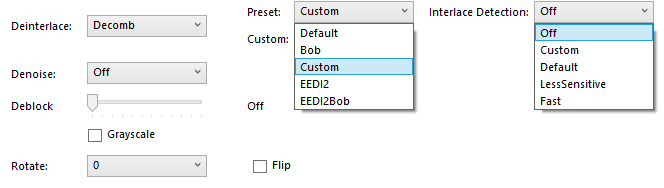

  2. Your problem has nothing to do with h.264 encoding. It's a deinterlacing issue. Try using decomb instead of deinterlace in HandBrake.
  3. Originally Posted by jagabo View Post
    Thanks. How do I use decomb, which settings do I input? This is my first ever encode. Here's a screenshot of Handbrake:
    Edit:
    I'm still getting the weird distortions at the top with Decomb (Default) & Interlace Detection: Default.
    Any help please?

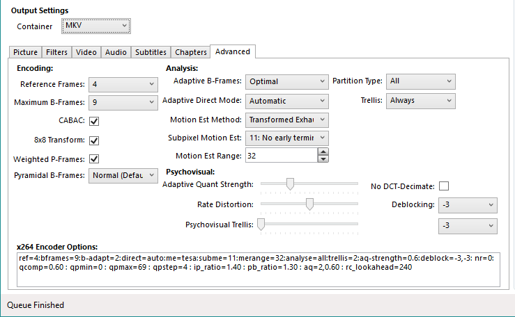

    have you any good reason to convert it to 10bit Bit depth instead of 8bit? And you can try to lower AQ strenght to 0.5-0.6. .
    And 16 bframes is too much. I usually used max 5.

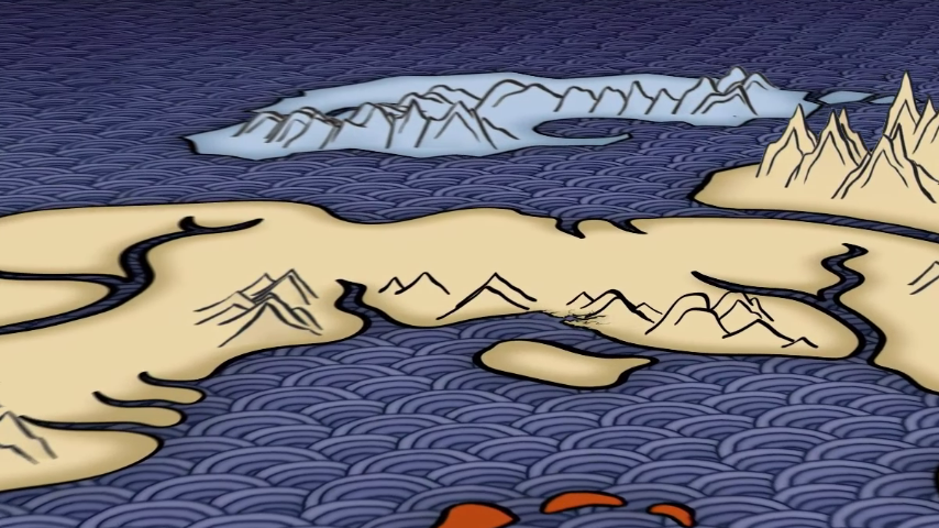

  10. Originally Posted by manono View Post
    Why are you doing anything to it? It's already progressive. It doesn't need 'decombing', 'detelecining', 'deinterlacing' or anything else.
    I did not use any filters but ended up with this:
    http://screenshotcomparison.com/comparison/172870
    Any ideas?
    Originally Posted by Bernix View Post
    Just try, I have very slow computer
    Wow. Your version is a lot cleaner (and dare I say almost identical to the source). Which settings did you use or how did you fix the issue?

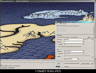

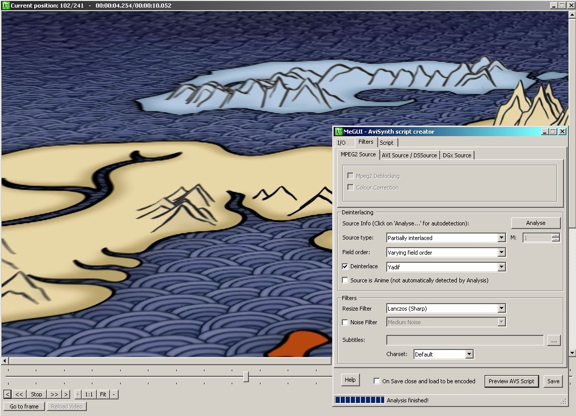

  13. Here's your sample opened in MeGUI's preview via Avisynth (open the images in new tabs or save them to view full size):

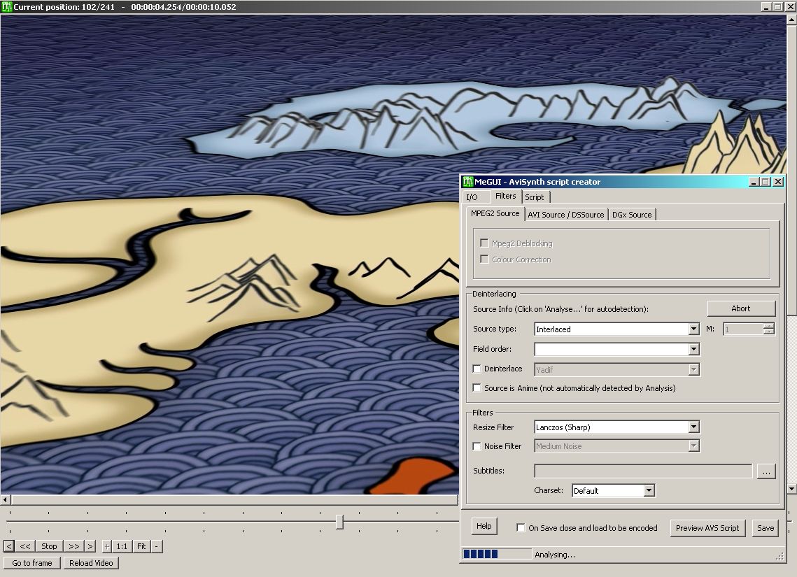

    Here it is again opened in MeGUI's preview after MeGUI analysed it and incorrectly decided it was interlaced. Nothing encoded. Just decoded and with de-interlacing enabled:
    If you're using MeGUI's script creator make sure there's no de-interlacing enabled.
    If you're using the OneClick encoder, open it, select "show advanced settings" and make sure "automatic de-interlacing" is unchecked, due to the "getting it wrong" problem (I don't know for sure if that'd be the cause as I never use the OneClick encoder myself).
    If you happen to be using DirectShowSource for opening the video, probably better not to, but if you are, make sure your DirectShow decoder isn't doing any de-interlacing. That's out of MeGUI's control.
    I don't know what Handbrake is doing but logically there must still be some sort of de-interlacing enabled.
    Edit: I opened the sample with MeGUI's File Indexer and indexed it with L-Smash.

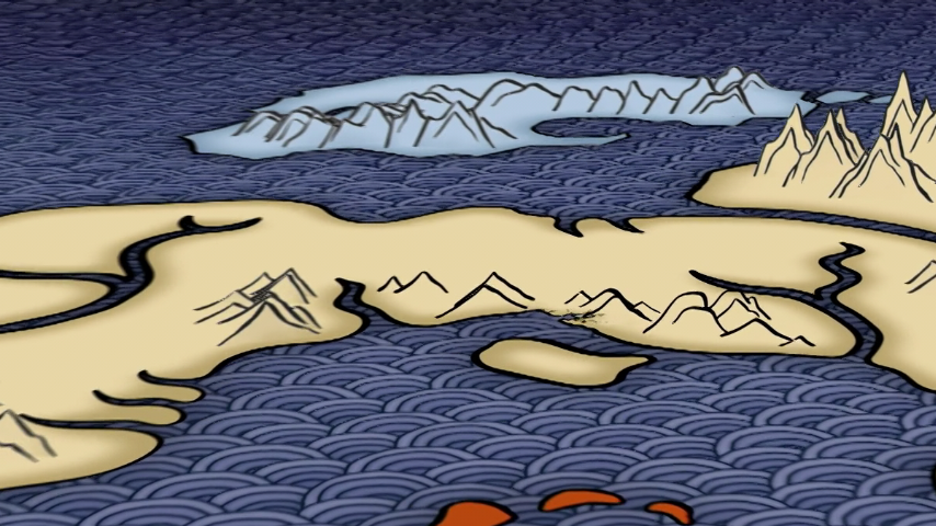

  16. Thank you everyone!
    Managed to resolve the issue. Both Handbrake/MeGUI had deinterlacing/decombing enabled by default. Once I turned it off, the encode appears acceptable now:
    http://screenshotcomparison.com/comparison/172872
    Settings used:
    x264 10 bit
    CRF = 18.0
    Constant Frame Rate (same as source)
    Encode (57% size reduction)

  18. Yes, 10 bit and 9 b-frames will kill compatibility with most hardware, like blu-ray players.
  19. Yes, you definitely should be aware if you use 10 bit encoding you're pretty much going to be limited to PC playback. There's almost no hardware player support.
    10 bit decoding will be more likely to become mainstream as h265 does, as 10 bit has been part of the HEVC standard from the beginning. There's no guarantee it'll ever become mainstream for AVC. I suspect it won't.

    As a test I encoded the sample using the 8 bit encoder, Tune Film, Preset Very Slow and High Profile level 4.1.
    The file size was exactly the same as the your sample 10 bit encode and they're very, very similar in quality. Comparing them frame by frame I could see small differences in the way some frames were encoded but neither was "better". Sometimes the frame from the 8 bit encode matched the source frame more closely, sometimes it was the 10 bit frame, but that's always going to happen when you use different settings whether the encoder is 8 bit or 10 bit.
    Personally, I'd keep "anything can play it" as a higher priority the banding (which is an issue) but that's just me.
    These days, I stick gradfin3() at the end of most scripts (from the dither package) and always when using noise removal, and colour banding isn't much of an issue.
    Thanks for sharing your experience. Appreciate it.
    I'm re-encoding via 8bit x264 now. My 10bit encode crashed overnight (ran out of memory). 10bit and rc-lookahead = 240 may not have been a good idea with only 8 GB of memory. The program was using 7 GB of RAM before it crashed.
    Handbrake's encoding fine now, with 1123 MB memory usage.
