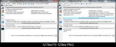

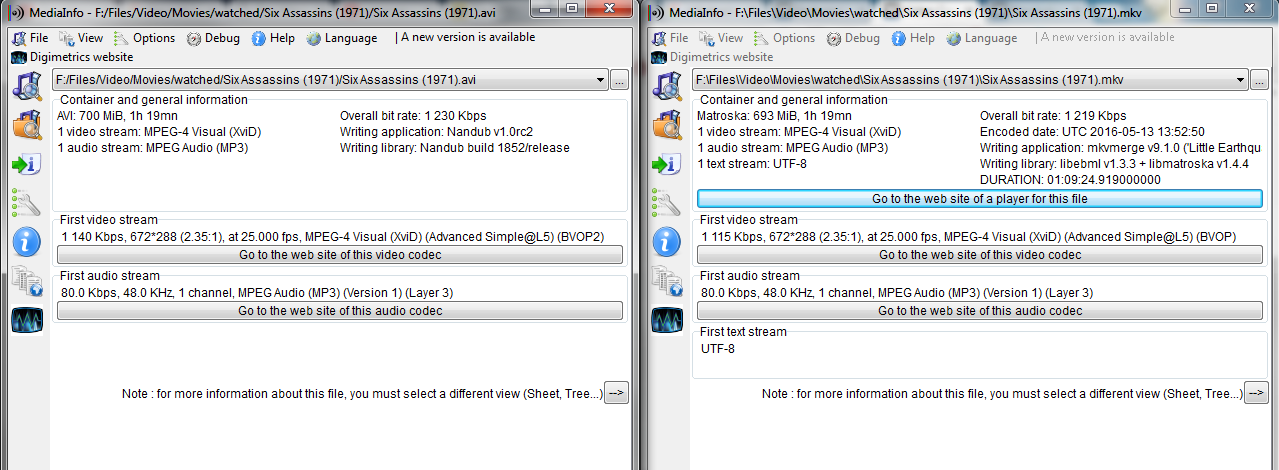

  1. I have a bunch of old avis and separate subtitles I wanted to join together with MKVToolnix, which as I understand shouldn't do anything to the input files since it only muxes them. However each file I tried combining with the sub file resulted in a smaller mkv. Mediainfo (and Windows) reports a reduced overall bitrate. How do I prevent that, or is there another alternative program that doesn't muck up my files?
    Here's an example, the same thing happens with every file:

  3. Different containers, different overhead. Also, MediaInfo only estimates bitrates.
  4. I set "no extra compression" on all three input files (video, audio, subs) and the mkv file still ends up smaller. I can't spot any distinctive visual degradation (video quality sucks in the first place) and the length is the same as well, so I guess it's the avi overhead?
  5. Member Bernix's Avatar
    Apr 2016
    Europe
    In avi it usually take 5MB per hour (overhead) depends on program. From wikipedia
