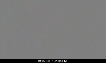

  6. I made 2 encodings with CRF 0, using both ultrafast and placebo presets. The output looks like exactly same for both.
    First sample:
    Ultrafast:
    http://i.imgbox.com/U5jRtBwX.png
    Placebo:
    http://i.imgbox.com/Y1jSPRpl.png
    Second sample:
    Ultrafast:
    http://i.imgbox.com/Ps6E6Xug.png
    Placebo:
    http://i.imgbox.com/AfjtYzQl.png
    Third sample:
    Ultrafast:
    http://i.imgbox.com/FrnFywzy.png
    Placebo:
    http://i.imgbox.com/ERkWyowe.png

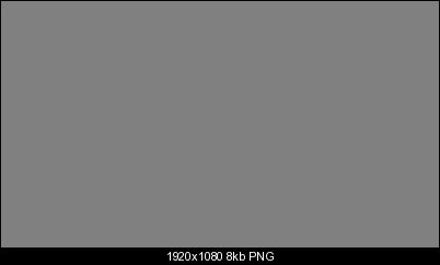

    Anyway here are the subtraction photos done in avisynth, and each pair of images provided by OP have the exact same CRC-32 hash.
ID:	36995Click image for larger version
    #example of script used on each subtraction image
    A=ImageSource("...Ultrafast_2.png")
    B=ImageSource("...Placebo_2.png")
    Subtract(A,B)

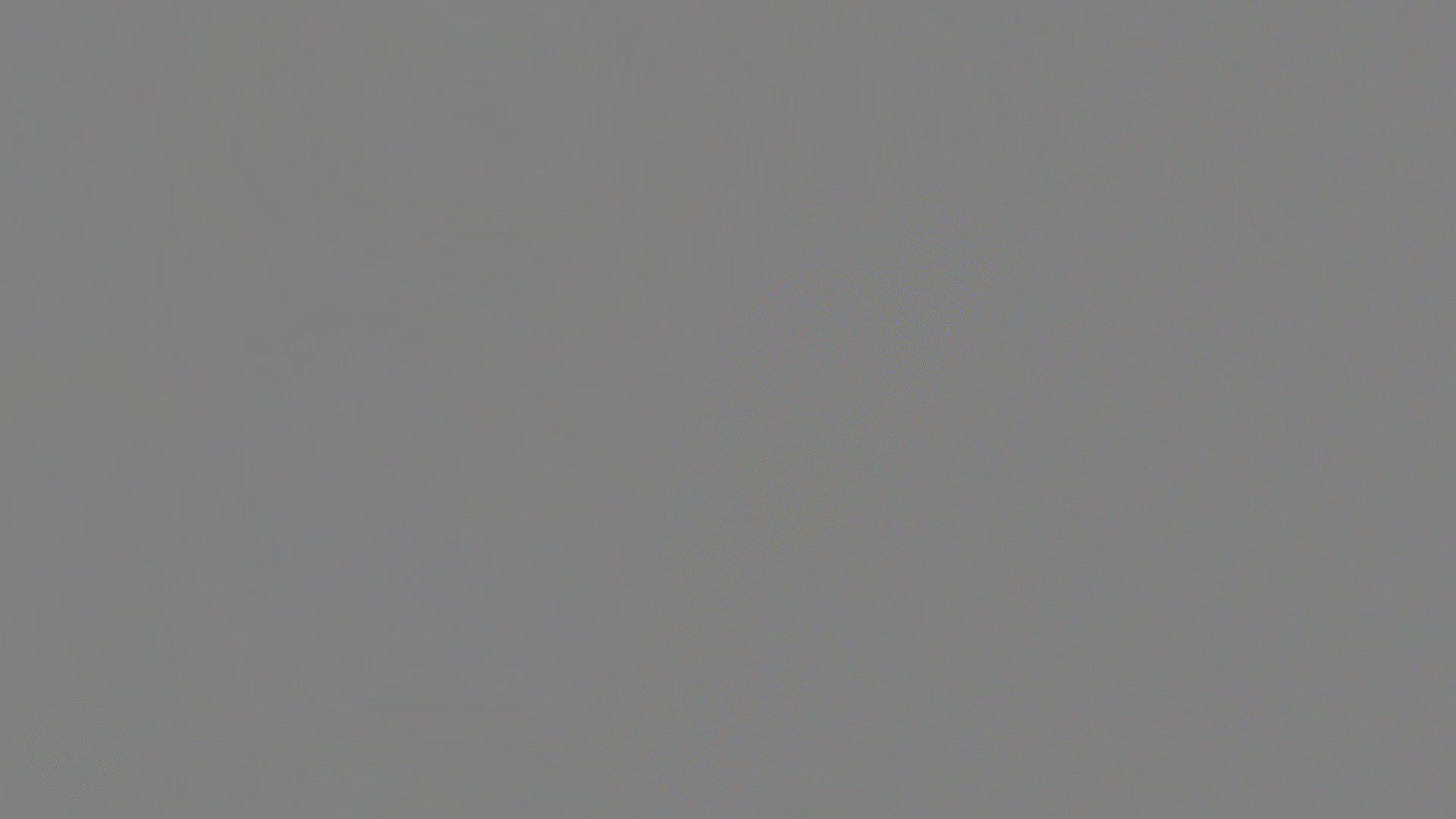

    For fun I took the frog image and then converted it to JPEG using different quality settings, then subtracted the JPEG from the PNG source.
    JPEG Quality=100 in Paint.NET (4:1 Compression ratio over the PNG)
    JPEG Quality=50 in Paint.NET (32:1 Compression ratio over the PNG)
    Should point our the PNG image is already losslessly compressed and so skewing down the compression ratio, which would be higher compared to raw BMP.
