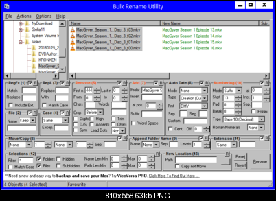

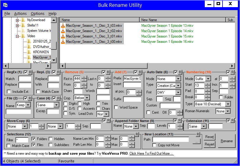

    I'm trying to use bulk file renamer to rename MacGyver_-_Season 1,_Disc_1 to MacGyver Season 1 Episode xx . where xx is counted from 13 to the end of the amount of files. Does anyone use this ap and know how to do this? John

  17. I'm trying to use bulk file renamer to rename MacGyver_-_Season 1,_Disc_1
    1. Highlight all (Ctrl+a)
    2. Remove (5) First n - Any number higher than used.
    3. Add (7) MacGyver Season 1 Episode
    4. Numbering (10) Suffix Start 13
    5. Hit Rename
Name:	Screenshot - 5_20_2016 , 10_20_24 PM.png
