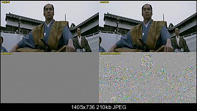

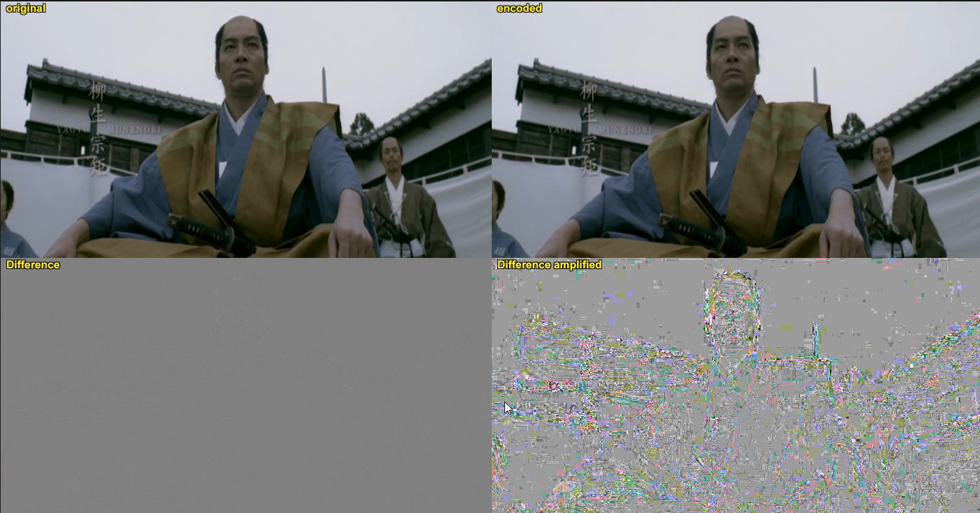

    If you are looking to just compare or create a comparison video, I think poisondeathray's suggestion for avisynth is the best. You can compaRe and stack how ever you would like.
    v1=directshowsource("C:\Users\Bud\Desktop\[dp]Manjandani-1.mp4", audio=false).ConvertToYV12()
    v2=directshowsource("C:\Users\Bud\Desktop\[dp]Manjandani-1_2.mp4", audio=false).ConvertToYV12()
    sub = v1.subtract(v2)
    substrong = sub.levels (122,1,132,0,255)
    StackVertical (StackHorizontal (v1.subtitle ("original"),v2.subtitle("encoded")), StackHorizontal(sub.subtitle("Difference"),substrong.subtitle("Difference amplified")))
Name:	ScreenHunter_192 May. 11 17.16.jpg
