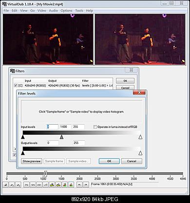

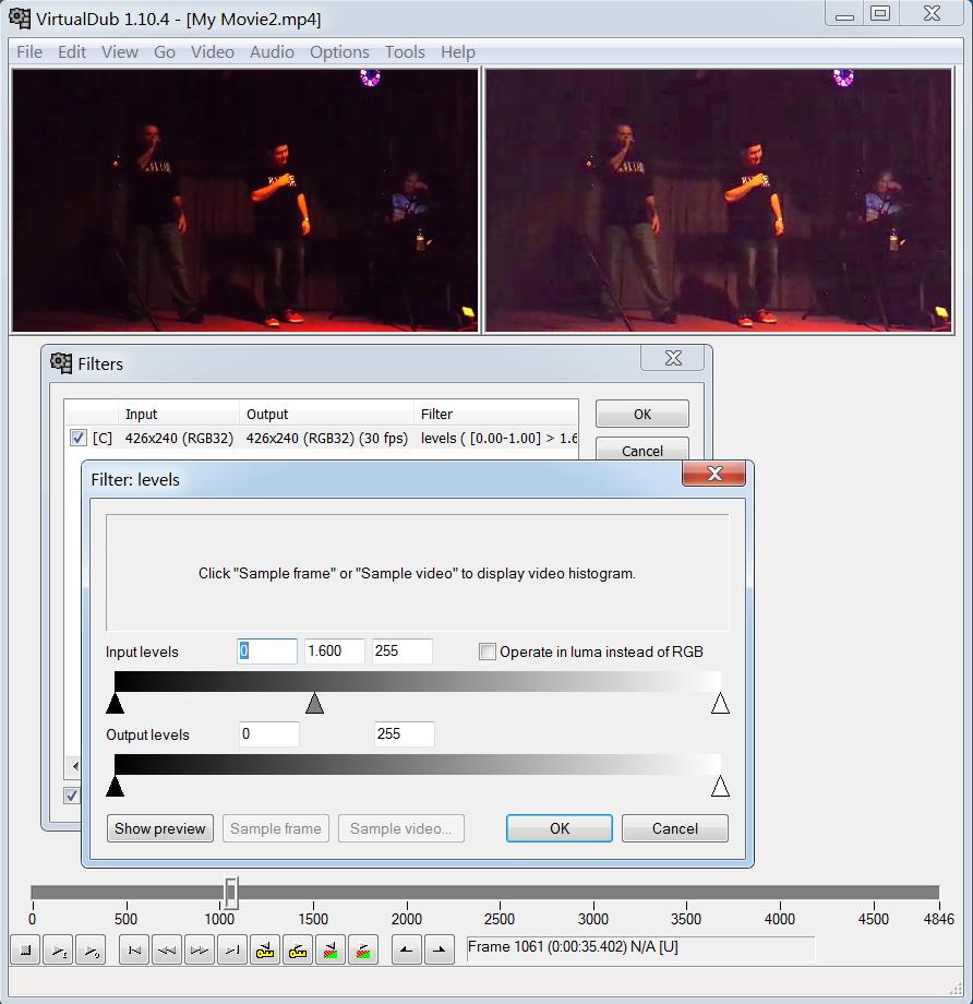

  9. Yes, after seeing the video a gamma correction and probably some saturation reduction would be in order. If you're going to use VirtualDub you can use the built in Levels filter to adjust gamma.
