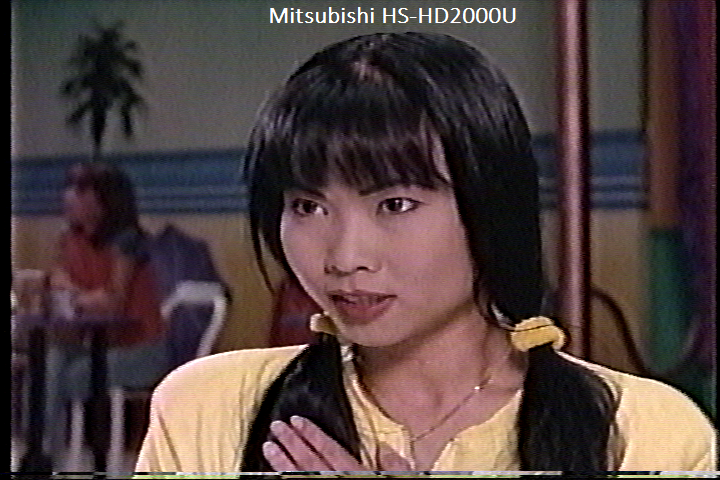

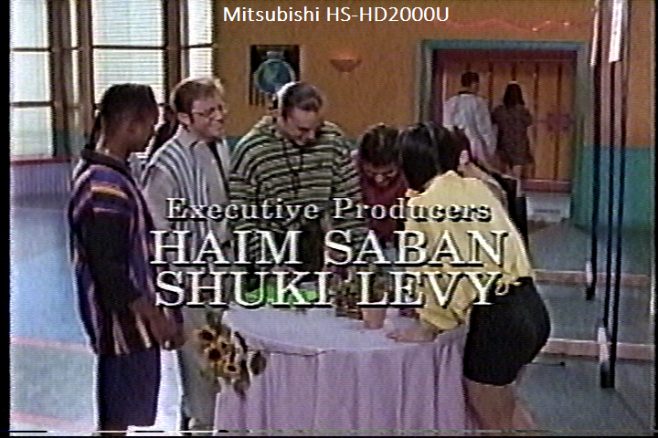

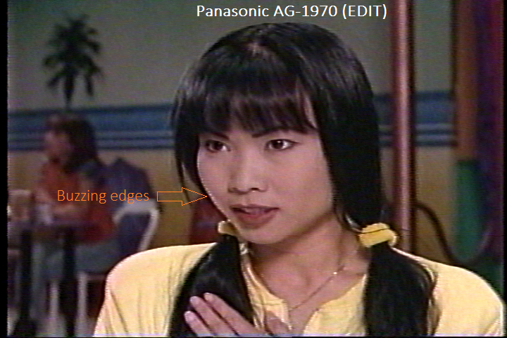

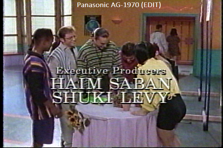

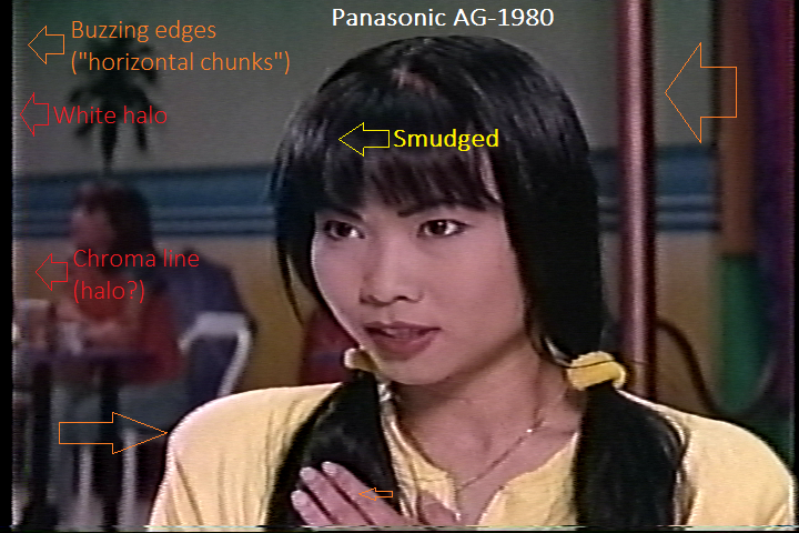

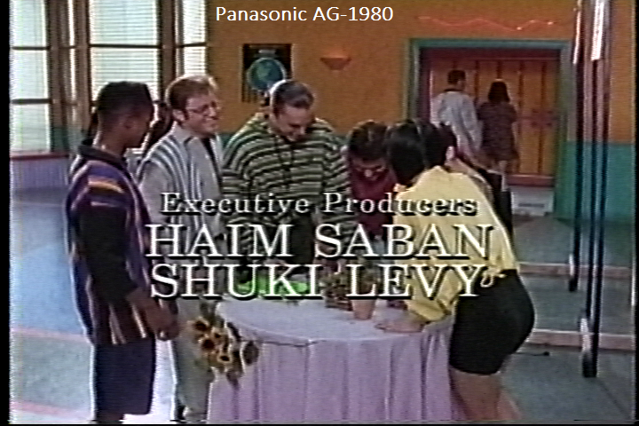

    This is a comparison of many VCRs playing the same retail EP/SLP mode tape. Your opinions are welcomed.
    The three ZIP files include 20 lossless AVIs encoded with Ut Video, comprising 17 different VCRs. The extra 3 files are because I'm showing different settings for the AG-1970 and AG-1980.
    Each file is 200 frames (6.6 sec) long. Even so, the large number of files adds up to an obnoxious 1GB, so I don't expect many responses.
    A few screenshots with some of my criticisms scribbled atop:
Name:	137 - Mitsubishi HS-HD2000U (-DNR&TBC, PPT Normal).png
ID:	36943 Click image for larger version
Name:	137 - Panasonic AG-1980 (-TBC, DETAIL, Sharpness Mid).png
ID:	36944 Click image for larger version
Name:	137 - Panasonic AG-1970 #2 (-TBC, EDIT).png
Name:	194 - Mitsubishi HS-HD2000U (-DNR&TBC, PPT Normal).png
ID:	36951 Click image for larger version
Name:	194 - Panasonic AG-1980 (-TBC, DETAIL, Sharpness Mid).png
ID:	36950 Click image for larger version
Name:	194 - Panasonic AG-1970 #2 (-TBC, EDIT).png
ID:	36942 Click image for larger version
Name:	194 - Panasonic AG-1970 #2 (-TBC, -Filter, Sharpness Mid).png

    • Some of the units were clearly in poor repair judging from the output, like the Citizen CVCR401H, but I included them anyway.
    • The content itself has some sort of frame blending especially visible at shot changes, so it's difficult to evaluate the temporal effects of any DNR filters present in the VCRs using this material.
    • I removed a portion from the clips, so that they include both a regular scene and the non-moving end credit frame without making the files needlessly larger.
    • I wasn't able to use any line TBC for most of the captures, so you'll have to try to look past the wiggles.
    • All of the ATI 600 USB captures were done with the proc amp set to 110-32-64-32-0 (defaults, except sharpness lowered to 0).

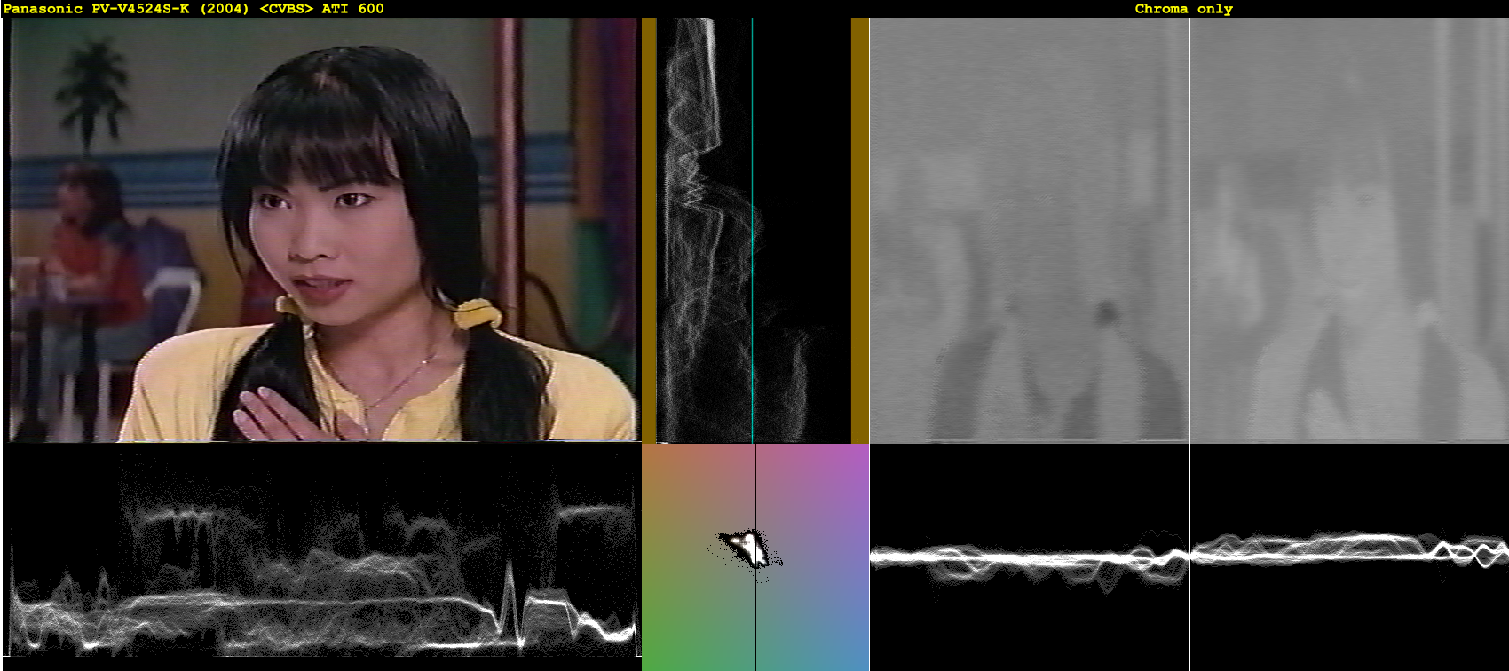

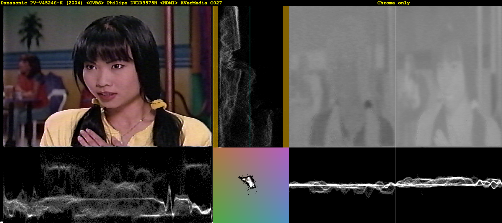

    There were two main workflows: the portable ATI 600 setup, and the DVDR3575H-to-HDMI setup. There's that one HDMI capture where I happened to use a different card, but the small chroma scaling difference should be completely invisible with VHS source.
    The ATI 600 was the only option in most cases, so leveling the playing field would mean using it for the rest, even though the added waviness makes comparison more difficult. To me, it isn't worth making everything worse.
    There is one VCR that I was able to re-capture using the better setup. I've attached the clip to this post, so you can compare it to the ATI 600 one that was previously posted and see what sort of variables the workflows impart.
Name:	137 - Panasonic PV-V4524S-K (2004, small head switch) =CVBS= ATI 600.png
ID:	37606 Click image for larger version
Name:	137 - Panasonic PV-V4524S-K (2004, small head switch) =CVBS= Philips DVDR3575H =HDMI= AVerMedia .png
    I see: uncorrected waviness of ATI 600, different comb filter artifacts, levels difference (easy to adjust if desired).
    What is troublesome is that the ATI 600 capture also appears to have an added halo. I can't explain this.
