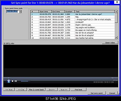

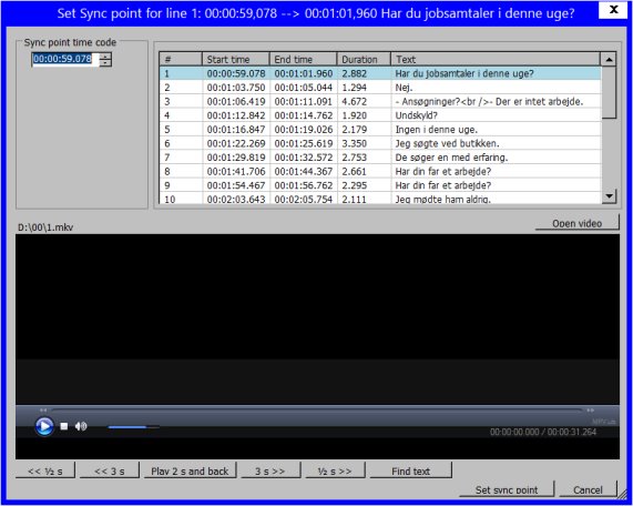

    You don't select the first 3 lines. On the left you select one of the first subtitles and have it fit the video. On the right you select one of the last subtitles and have it fit the video. Then you press Sync.

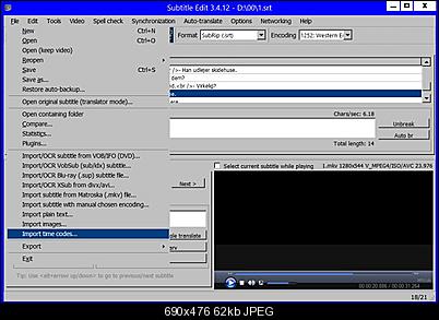

    Notice this is "Point Synch" not "Point sync via other subtitle ...". You select the first and last subtitles as sync points and enter (or paste) time codes. And it's very similar to Visual sync as you see the video.

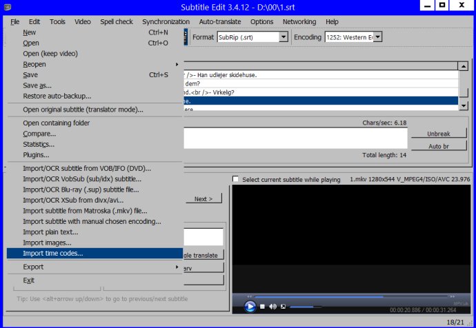

    And it is a misunderstanding if you believe the two subtitles when using "Point sync via other subtitle ..." needs to have the same numbers of lines. In your previous case you could sync say 10 lines in the english subtitles based on the timecodes from 8 lines in the thai subtitle. To have the same number of lines in two subtitles is mostly important when importing the time codes from one to the other - and even then you can sometimes get by with different numbers of lines.
